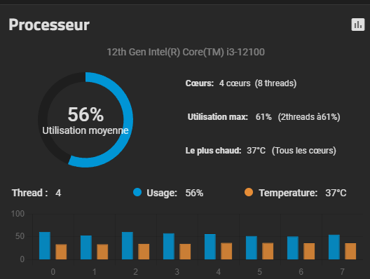

My Plex is running fine but when it transcode, my CPU jump to 54% and for some reasons one of my friend using my server (which she doesn’t have 4K device), the file is loading during 10min every 3min of watching. So I think maybe if I use hw transcode, it will be better
This what i get when I’m transcoding a file (without hw transcoding) :
That extra detail definitely helps, an i3-12100 is a quad core chip with 8 threads, so this kind of utilization rate for plex doesn’t seem horrible. Intel CPU’s have QuickSync which is supposed to be incredible for transcoding.

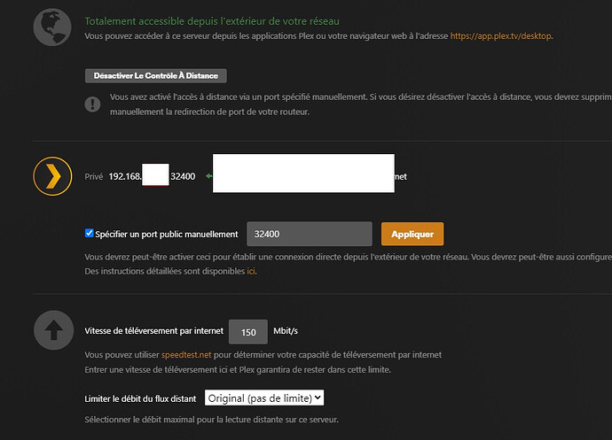

I’ve already turn on remote access :
The user device is a 1080 monitor but even when she watches a 1080 file, the buffering is very long

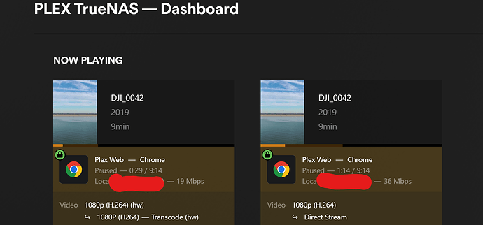

For a few weeks after installed PLEX and allocate iGPU’s, everything worked correctly. But I notice with my setup sometimes after restart the server, the iGPU’s are not present anymore. It has something to do with connection of the monitor on the motherboard that’s missing and looks like initialization of the iGPU skipped. If someone knows more about this behavior please share info or correct me.
It’s definitely a big change in CPU load when enable hw transcode. It’s just chilling and do the math.
Can you verify you don’t see the hw sign in PLEX dashboard?
And maybe you can look into the PLEX console and see if there is some significant information and share it.

But I’m interested in your logging in PLEX itself. Because you allocate within the app your Intel 730, but hw transcode is not present.
PLEX website info | related
As the page formulate, no hw sign = no hw transcoding.

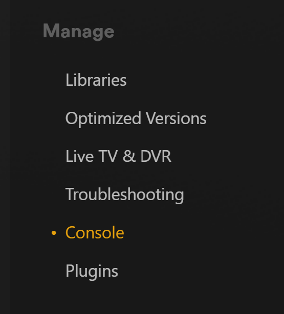

What do you need to see in the Plex console exactly ? Because there is a bunch of lines there :sweat_smile:

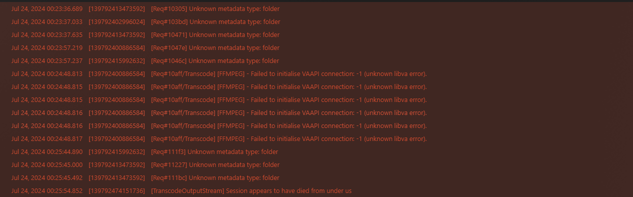

That’s what i get when I force transcoding :
Hello ZasZ,
Well, I think this give some relevant information. Because of my knowledge, I only can help to share relevant information regarding your input.
Found a lot when enter this error into Google. Suggest to read the cases related.
Verry curious what cause this problem.
