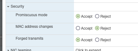

Found the solution…
I’m running TrueNAS on a ESXi Server. The security features of the virtual switch block network access when bride is enabled.
Allowing both Promiscuous Mode Operation and Forged Transmits solved the issue
