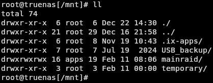

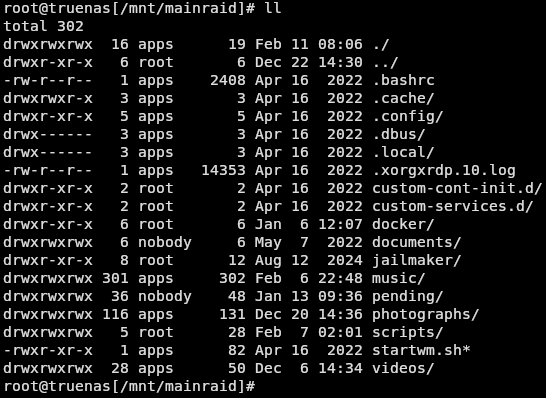

Unfortunately, being slightly less well informed than one or two other forum members (i.e. I am a very basic beginner and pretty well everyone knows and understands more than me!) I have failed to find on my Electric Eel box where the dir containing the snapshots is.
This is what’s in my /mnt/
and this is what’s in my main "tank" (called “mainraid”)
Where might I find the snapshots please - can you help?
I think I might want to create some tiered snapshots of /mnt/.ix-apps (so I can experiment with a few things to do with apps which I sometimes mess up).
Of what dataset precisely do you want to examine a snapshot? The snapshot directories are not visible in e.g. ls, yet you can still cd into them.

Oh! That’s simple enough, even for me. I hadn’t realised an OS could “hide” .dirs such that bash commands like ls won’t show them. Thanks.
I was thinking about creating a tiered snapshot for /mnt/ix-apps/ such that I can dig into it if I get stuck with some of the apps (Frigate in particular, although that might be less of a problem now that I have set up some of the config in a better way).
I already have tiered snapshots set up for my main data (documents, music photographs etc.) but not for the ix stuff.
