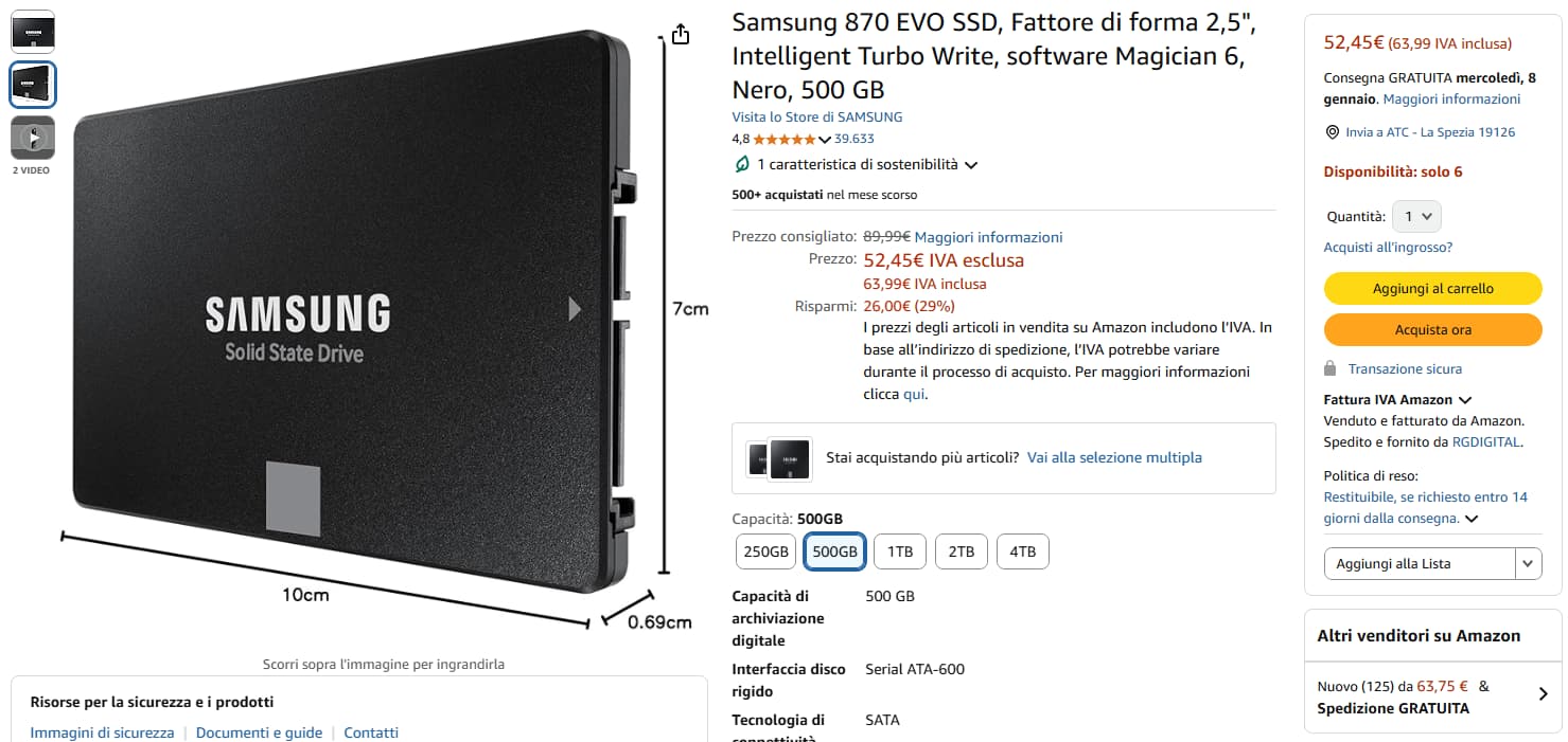

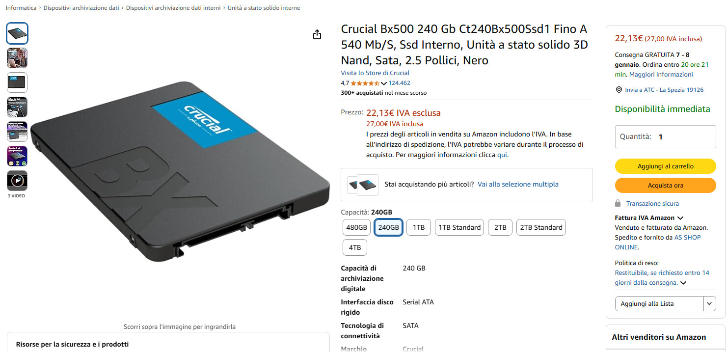

Would this be ok for booting the operating system?
Are all possible APPs installed on this support? I ask to have some margin on the space
IMHO 32gb Is more than enough.
But i understand will be hard found new small disks at a reasonable price… In case evaluate second hand you probably achieve a good disk for 5/10€.
Last day my boot pool die, i just slap in the first SSD laying around at home, waiting a 16gb optane NVME come (less than 5€). Last config provided by multi report, fresh install and back online literally in 15 minutes… Just for Say that boot pool Is not so critical to spent 30-40€ on it
Ok thanks, I prefer to buy everything new.
is that new ones less than 250Gb are no longer available and they cost almost as much as 500Gb ones
Multi-Report does not work in TrueNAS 24.10.1. The community is trying to solve a newly implemented “feature” in 24.10.1 and it is unfortunately not solved yet. I am working on a temporary fix that I hope is actually temporary.
I see something for less than 15€ on Amazon, we are talking about lesser-known brands disks… But for the boot pool they still will be good.
Your call, off course… Just remember that space on boot pool can’t be used for anything else ( and seeing the data write on mine, don’t think neither the tbw of smaller disks can be a concern)
