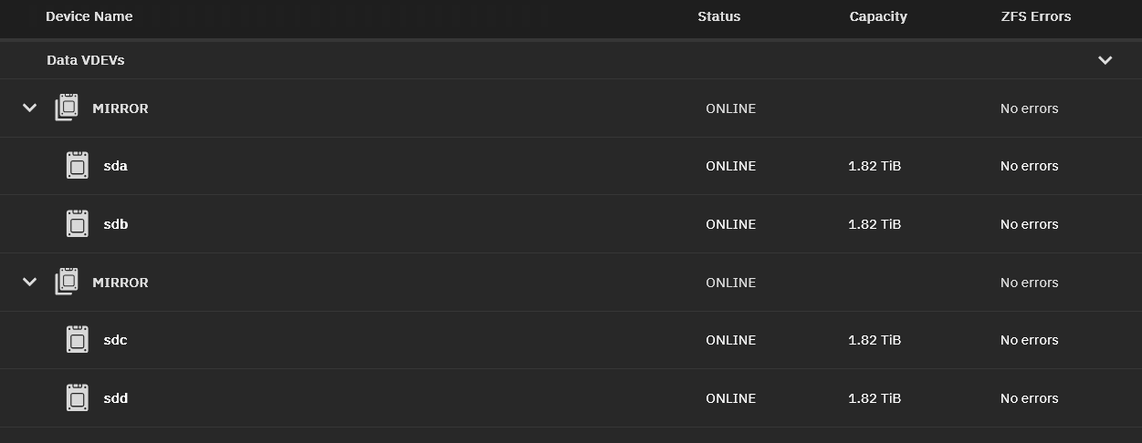

Hey all, when I build my initial system I started out with 1 mirror pool pool1 made up of 2x1TB NVME SSDs. I later added a second mirror pool with 2x2TB SATA SSDs.
I then recently expanded the SATA SSD pool pool2 with another 2x2TB as a second vdev.
Though I now have regrets about doing so, as I think making a whole new pool pool tmp as a RAIDZ2, migrating pool2 to pool tmp, deleting pool2 and extending the new pool tmp RAIDZ2 with the then freed up 2x2TB SSDs would have been the much smart upgrade path.
I would have had the same redundancy as with the current 2 Mirror x 2 wide pool2 but much better failure protecting in the event of one disk failing within every vdev and potential higher performance.
Now how would one go about doing this now? My pool2 is not above 50% storage usage yet so removing the second MIRROR and setting up pool tmp would probably be possible without any data loss.
Would this even be advisable to do or should I just stick with the current 2x2 MIRROR setup?

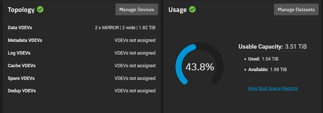

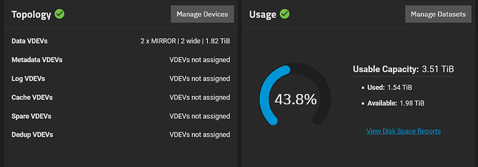

  1. Your pool is currently shown as 43.8% full, though this widget based on ZFS stats not ZPOOL stats and is not accurate - you need to run sudo zpool list to get accurate stats.
  2. If this is accurate, you have (just) enough space to remove one of the vDevs which will take the remaining vDev to c. 87.6% which is on the high side but should work. (You can remove a vDev from a pure mirror pool and it will move the data for you. If it is RAIDZ you cannot do this.) This will leave you with 2 free 2TB disks. Run a scrub to ensure your data is intact.

sudo zpool list shows 42% usage, but I can also clean up some of the space beforehand since some of it is just steam games that can easily be redownloaded. The rest is plex / jellyfin storage, that I would want to have to redo again.
