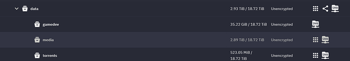

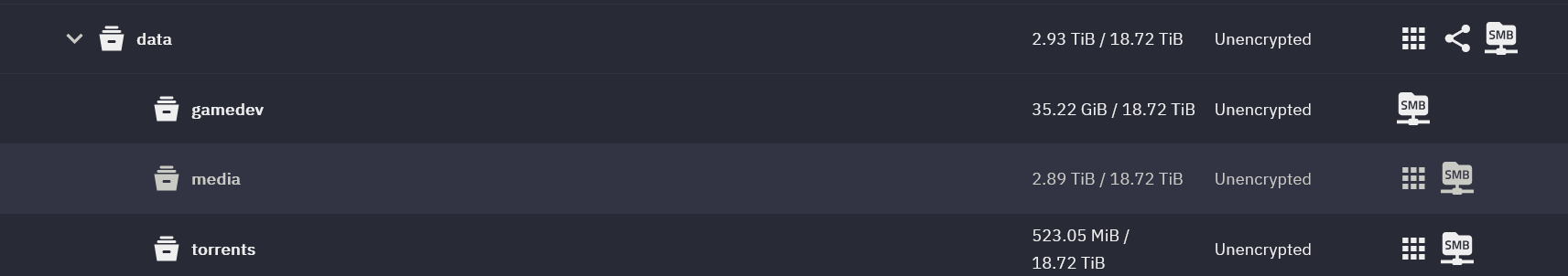

Sorry I’m pretty new to Truenas and English is not my first language. This is how is set up now.
And I would like it to be possible that files inside media and torrents to be Hard linked. And in order to do that my question was if just creating simple directories under /data Dataset move all the contents of /media dataset and /torrent dataset to those new directories is a good idea? Or is there a better approach?
