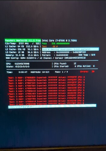

I find it pretty strange that you have 5 drives that expirience checksum errors, since I doubt this is the drives acting up.
That is why I would check PSU, HBA, RAM.

My vote here is just a simple question: Are your drives SMR? That makes sense to me with having so many issues.
I could be falling into a correlation vs causation trap, but everything was totally fine until 2 things were changed.

My gaming pc uses the exact same power supply so I switched them. Too early to tell if that “fixed” anything but my gaming pc has a brand new rx 9700 xt and the psu from my NAS is handling it just fine. I don’t have an HBA. These drives are plugged directly into the sata ports on my Z370 mobo.
Any tips on the best way to evaluate if my ram is contributing to this issue? I think that may be a logical answer as my other suspicion is these errors are only occurring during data transfers and my very limited knowledge tells me that all these files pass through the ram first before arriving at their destination.

Some CRC errors… Have you checked/reseated the sata & power connections? If you’re lucky it is that simple (sometimes swap sata data cable for something shorter/better quality).
Drives are connected directly to motherboard… Gonna guess TrueNAS is bare metal & not on a hypervisor.
Given the age of Z370 any chance chipset is overheating? Thats where my mind is going given how many drives having issues at same time.
memtest86+ or something like that form a Linux boot iso.
I would get an Ubuntu live iso, set BIOS to legacy, disable secure boot, and then boot from the iso, select memtest86+ as start option.
My quick take on the overall issues I see:
  1. You are not running any SMART tests on your drives. I recommend you run a SMART Long test on each drive, verify it passes on all drives.
  2. As @Sara stated, run Memtest86+, run it for 5 complete passes. Some errors take a while to show up, and hopefully by the 5th pass it does if you have a questionable RAM issue. Then run a CPU Stress Test like Prime95 for 4 hours or longer. You must ensure your system is stable, this kind of thing can cause serious problems.
  3. While the SMR drives may not be directly impacting your other pools, it could be causing slowdowns as the computer tries to write data to the pool but has to wait. I don’t think it is causing the SSD pool issues however stranger things have happened so I would not rule it out as a possibility, I just think it is a slim possibility.
Joeschmuck, Sara, Fleshmauler. Thank you. I will report back after I perform these tests. Thank you for all the help and advice rendered.
If you have questions, please ask, but if they seem sort of generic, try a Google search for “truenas scale” and add in any error message you get or something related to your question. There is a lot of help out there. But also, you can feel free to just ask us, we help people but if we can teach you to fish…
Good luck on the stability testing.
If you find that your RAM is failing, you can try to underclock it a tiny bit, if you are comfortable doing that, then retest. If you find a place that passes, write down the BIOS changes you made as you may need to restore it in the future. Also, run Memtest86+ for a long time to ensure the RAM failure is gone. Long time to me is 1 week. That is a lot of testing but it is your data. While ZFS is a great file system and will protect your data from corruption while it is stored on the pool, it can’t help the data if it was written to the drive corrupt. So, a good stable system is required.
Pulled out 2 ram sticks and I’m running memtest again. 2 hours in and no errors so far. Now I need another ram kit to test those slots to see if the ram was bad or if it is the slots.
May be it could be some dust at the slots as well. I have seen this kind of issue before. Try cleaning the ram slots with clean air (mild air pump - like the ones used with camera lenses).
Hope this helps, and you get to start a real happy new year…!
You cannot reconfigure your RAM? You said 2 sticks pulled, does that mean you have two sticks installed?
Recommended testing:
  1. After your current RAM have passed 5 complete test cycles (looks like you may think 4 is enough), then remove your RAM sticks that are installed, remember which slots each one was in.
  2. Install the two sticks you pulled in the same slots where you pull the current sticks from.
  3. Retest 5 times, or unless an error occurs.
  4. If an error occurs then you can expect one of the sitch installed to be bad.
  5. If you can run your motherboard on a single stick, remove the one stick you don’t need in the system and test.
  6. If it passes 5 complete test cycles, remove it and install the other suspect stick and retest.
Doing this will help you diagnose the issue without purchasing another stick of RAM.
