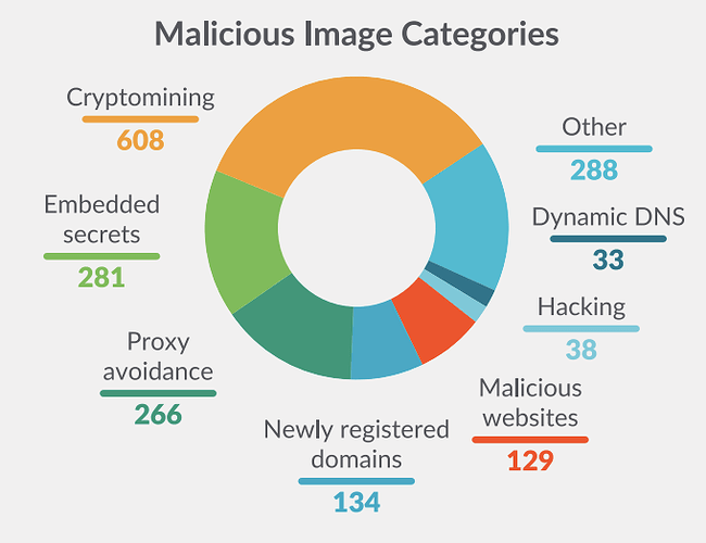

I think you meant articles like this one:
Or this one:
Which is a security companies promoting their products. By publishing blogs about something obvious
But even their conclusion was “use trusted image sources, not random crap containers”
