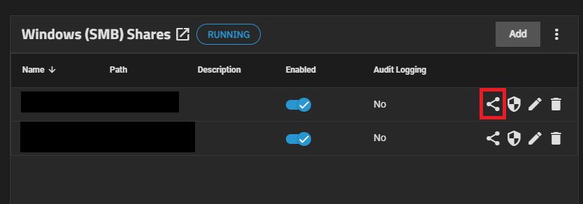

Configure the share ACL, it’s different from the filesystem ACL.
I would also recommend to not set “hide unreadable” and “hide unwritable” - it’s not required for hiding shares in share enumeration and will only slow down folder enumeration.
Thank you! I didn’t know that the setting was separate.
So I accidentally just adjusted only the ACL settings from the file system…
This is how I hide SMB share from my familiy members:
Setting is under the “Shares” section, and my TrueNAS is ElectricEel-24.10.2.2
Keep in mind that my family is not tech-savvy and that the hidden share could be accessed via the direct link/shortcut if the user has been granted permission.
