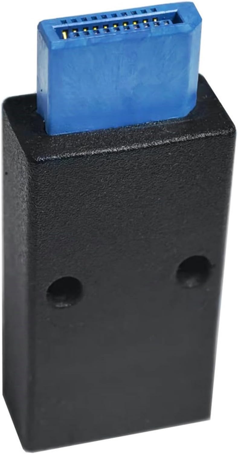

Some GPUs will disable ports at boot that have no monitor attached. A recent Linux upgrade for me on my desktop PC caused a similar problem.
One fix was to use a HDMI to DisplayPort adapter, (my monitor normally uses DisplayPort in for my desktop). Later, I used a special DisplayPort to DisplayPort pass-through dongle that fakes a monitor for the GPU.
I used something like this:
Note that this is not the exact make / model I used. Not sure if I could dig it up, since I bought mine several years ago.
Now is it annoying / silly we have to resort to things like this for simple functionality?
Yes, but it is cheap enough that I did it and simply moved on.

Thanks for this. I have tried a similar dummy plug but hdmi and without the pass through. Same issue. Unless having pass through is the trick? But I still don’t want a monitor attached all the time.

  3. Used a HDMI to DisplayPort adapter, worked most of the time. But, their were times it failed to bring back the display. Not sure why.
  4. Since I had a DisplayPort to DisplayPort pass-through that was supposed to keep the port & GPU active, I tried that, it works 100% of the time now.
  5. I have added “consoleblank=0” to my Linux kernel command line in Grub, (for my Gentoo Linux desktop, not TrueNAS SCALE), but have not bothered yet to check if that will work without the DisplayPort dongle. If it does, I may try and see if rebuilding the kernel with the option builtin will work too.
So, you have options.
Part of the issue is that TrueNAS SCALE, (and Core), are designed as servers. So server boards with IPMI / iLO / IDRAC / BMC / etc… won’t have this problem.
One last note. It is possible that a full power off of my monitor AND desktop will cause the DisplayPort to DisplayPort dongle to loose it’s stored 1080p60. At which time I might have to reboot twice. But, I do have a UPS which can last more than 30 minutes so it should be rare.
