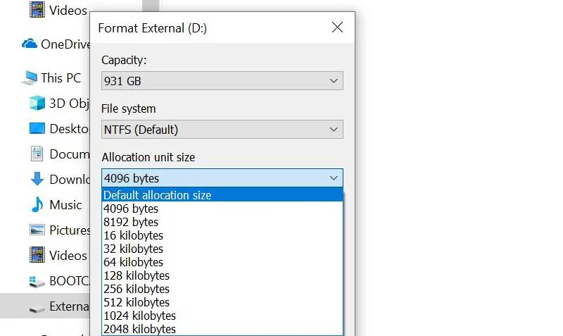

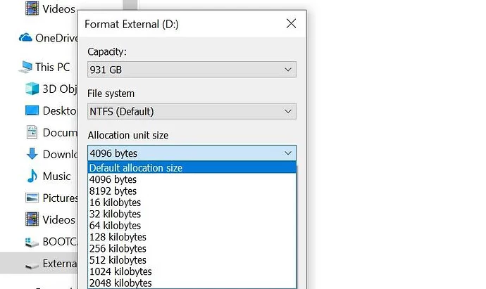

At OS level (e.g. Windows) you can do it
so I was just wondering if there’s something similar in TrueNAS Scale that allow the logical block change, without removing one by one the drives to be formatted in a Win baremetal.
That would be the “ashift” value, which defaults to 12 in TrueNAS. This uses 4096-bytes for writes.
That does not in any way affect the disk’s LBA geometry. That’s setting up a filesystem setting. As @winnielinnie said, the default in TrueNAS already is 4k, which is fine for 99% of users.
