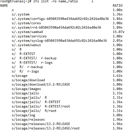

How do I get rid of compression?
I have two jails.
They show compression, but the pool ‘outside’ does not.
I can’t have compression active, as my backup solution complains about sparse files.

Yeah, no, that’s wrong. Compressed files are not sparse. And your backup solution is not worth even looking at if it can’t deal with something as simple as a sparse file.

It’s hard to say, but compression is not the source of whatever the exact problem is. Probably best to keep it enabled.
As for how to address your issue, that will depend on what is really going on with said supposedly sparse files. Are they really sparse, i.e. do they have holes in them? Is there a way to mount the NFS share without reporting holes in files?
