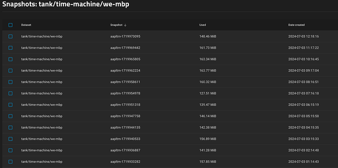

  • Ran a Time Machine backup. It was successful. TrueNAS created an mba-2022-01 dataset inside the TimeMachine dataset where it wrote a mba-2022-01.sparsebundle directory. TrueNAS also created an automatic snapshot on the mba-2022-01 dataset the the backup completed.
  • I left it run for a day to make sure it kept working. Then I repeated the Time Machine setup steps on the other Mac. It also worked.
