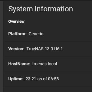

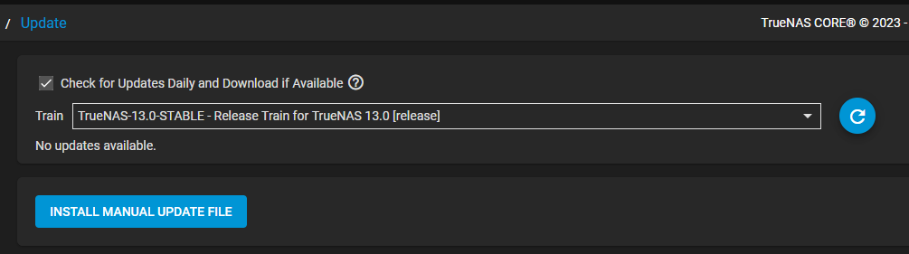

Well I bought a brand new SSD boot drive, removed the old one, added the new one, installed 5.1 and went to run the updates and it is stuck at the same 66.67% Installing base-os (1/3) and the logs have the same plugin_dispatch_values like before. Anyone have any other ideas on how to troubleshoot?
I would manually install 6.1.
