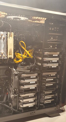

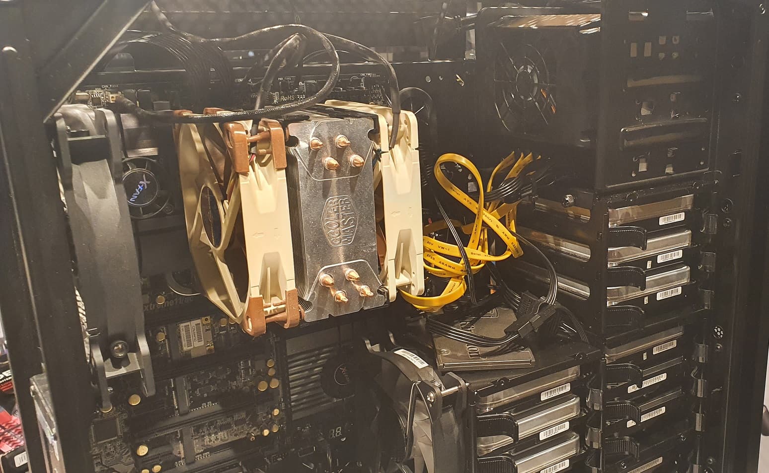

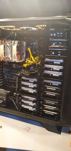

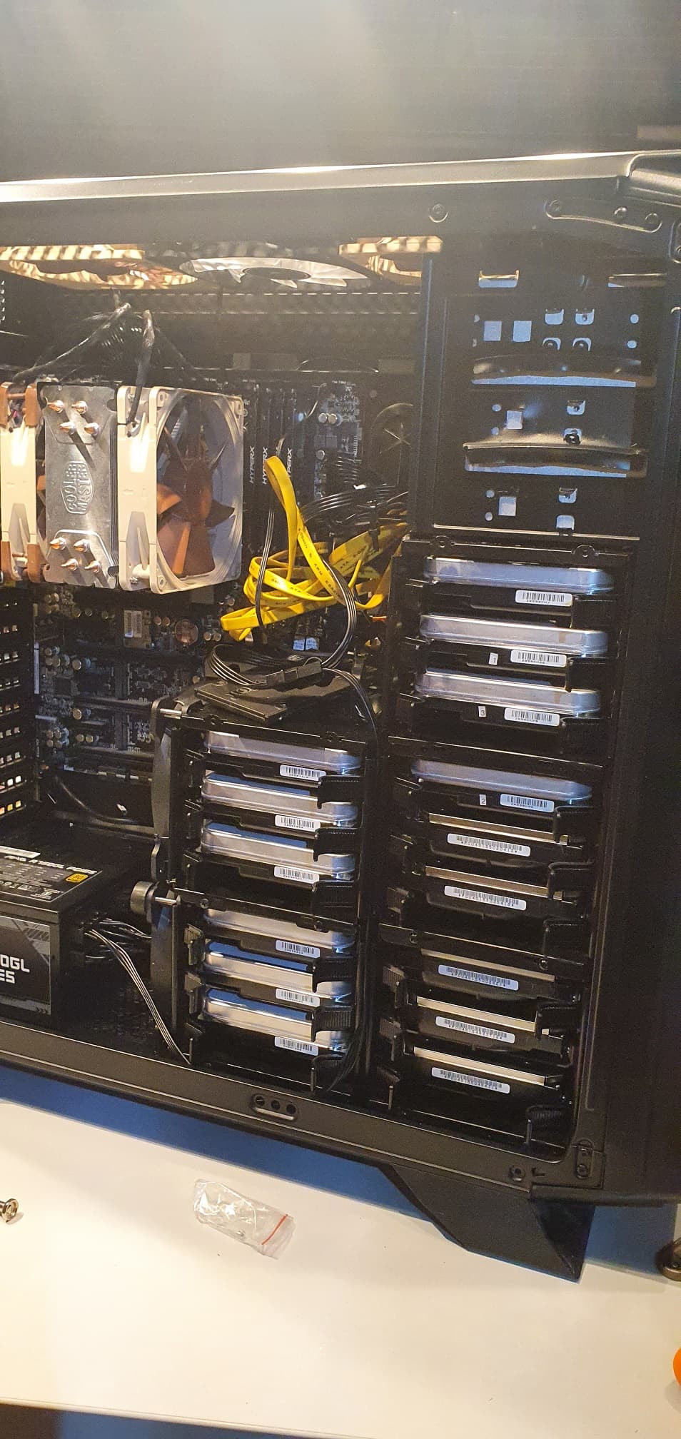

So my first (of probably many) TrueNAS enclosures is complete. after about 10 months thje first pool was at 80% so the second was installed.
10x18tb and 10x20tb in zfs2
Man i love the Asrock Extreme 11 AC mobo with 22 sata ports ![]()
power draw in idle is 250w, at load its about 315w. that includes the powerwalker ups.

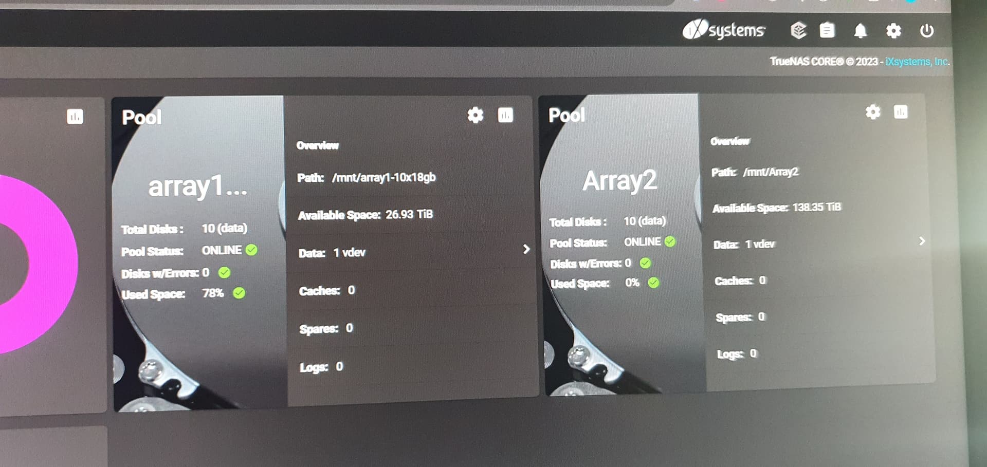

So, my current pool which is set up as one vdev is seen by windows as one ‘disk’, and every consequent pool the same.
Almost but not quite. Each share you create is seen by Windows as one disk. If you create only one share per pool, that’s one “drive” per pool, yes.
Make sure not to share out the top level “root” dataset of the pool, though. Create at least one dataset and share that.
