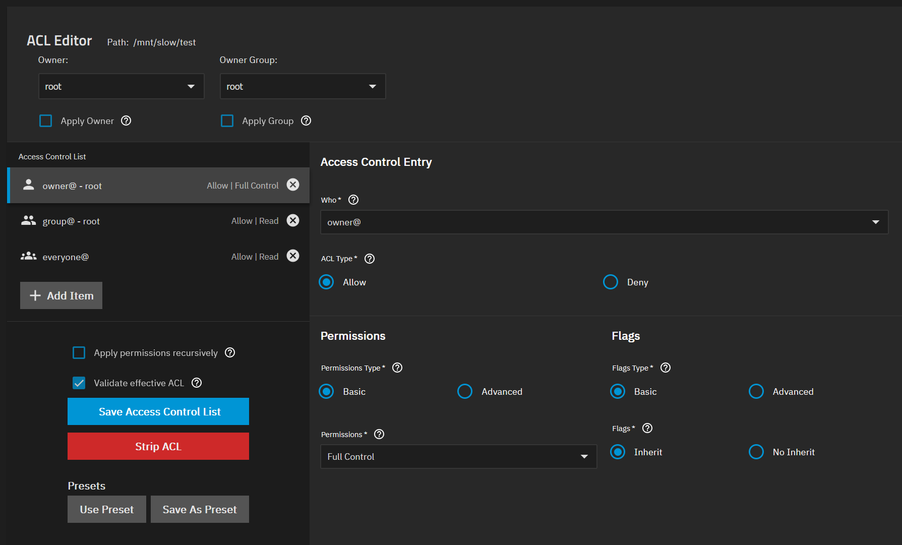

I made a test dataset and created a file within, here are the permissions as seen in TrueNAS:

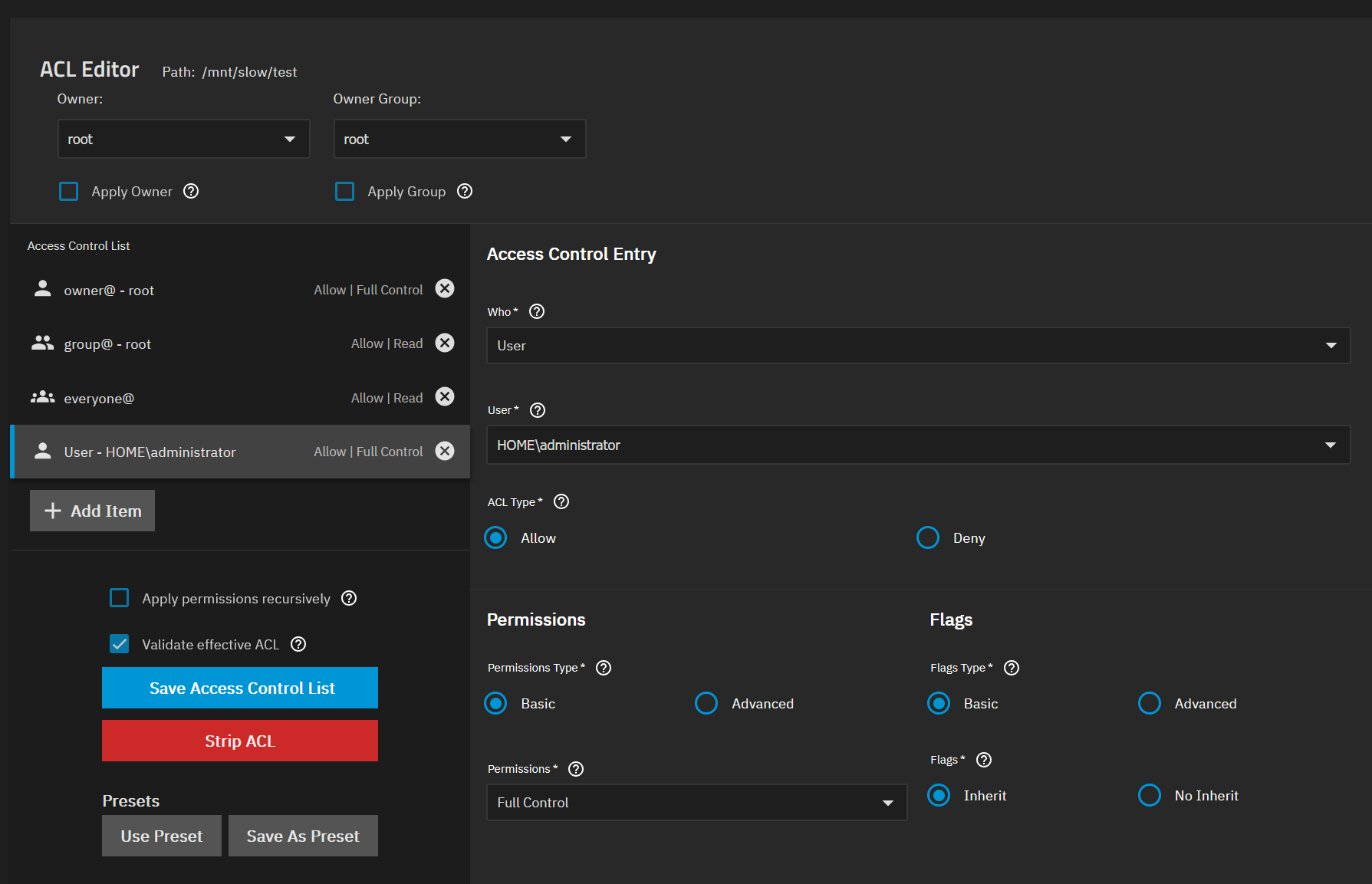

Checking from the UI:
