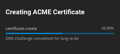

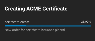

no, when I try to create a certificate it sticks here:
Is there a possibility to debug?
After a while I received this error message:
[EFAULT] Certificate request for final order failed: Authorization for identifier Identifier(typ=IdentifierType(dns), value=‘lang-w.de’) failed. Here are the challenges that were not fulfilled: Challenge Type: dns-01 Error information: - Type: urn:ietf:params:acme:error:dns - Details: DNS problem: NXDOMAIN looking up TXT for _acme-challenge.lang-w.de - check that a DNS record exists for this domain Authorization for identifier Identifier(typ=IdentifierType(dns), value=‘lang-w.de’) failed. Here are the challenges that were not fulfilled: Challenge Type: dns-01 Error information: - Type: urn:ietf:params:acme:error:dns - Details: DNS problem: NXDOMAIN looking up TXT for _acme-challenge.lang-w.de - check that a DNS record exists for this domain
