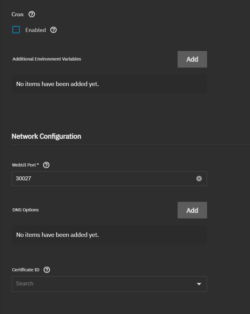

Thank you so much, I ended up deleting nextcloud, I am goin to install it again, sorry I am not to expirienced with all this. I want to use my nextcloud from outside of my network, through *****.duckdns.org. Do I need to make a network alias or something? and port forward or something? or do I use cloudflare tunnel? How are you accessing yours from outside of your network?
and to do that what to put here:

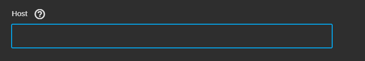

Starting with TrueNAS, I’ve added a network alias to my bridge group. I added this so I could explicitly add it to the Nextcloud app and have it bind to it. I know it’s not 100% at this time but until TrueNAS supports it offically it works for me.
In the line for “Host” I add the IP that I added as an alias to my bridge group.

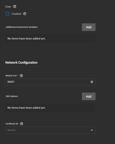

i did this:
i put the ####.duckdns.org in
and port is 3###7.
now when i use that link from outside of network it takes me to nextcloud login page.
and port forwarded 80 and 443 to 3###7
and it only works when I use WAN - DMZ to epose my server ip
any problem with this setup?
