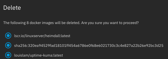

You can also go to Apps Configuration > Manage Container Images rather than running docker prune in shell. Just select all images, click batch Delete, Confirm and delete. As long as you don’t click Force, Docker will automatically clear only the inactive images.

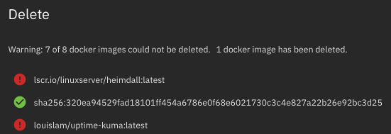

Huh, that is not obvious to the uninitiated…
Edit:
In fact, the wording directly suggests otherwise:
Only after clicking Confirm without Force does it become clear it didn’t/couldn’t remove all 8:
Had you not said what you just did, I would not have risked it, even if the containers can be redownloaded easily.
Agreed, the presentation could be clearer there. I think it is an issue of the UI not currently having a concept of which images are in use during that first confirmation step.
