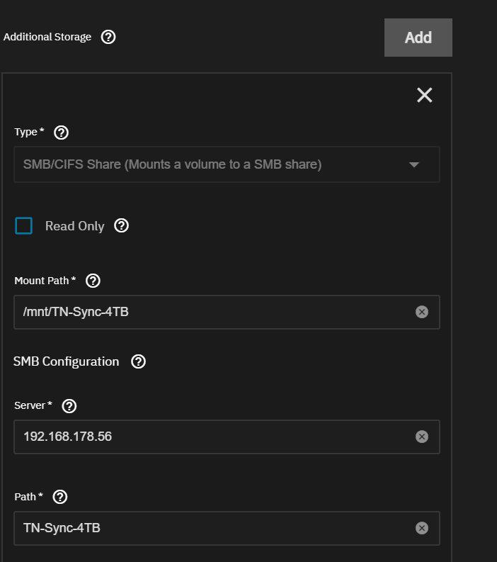

Using the module i can configure a SMB Share however i dont know how to configure it to PUSH data to it.

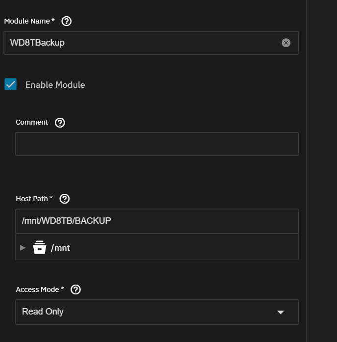

its still not clear how to configure the module.
1.) Do i need to enable the module? as i would specify the same host path again as in the rsync task … which wouldnt make sense
Or can this remain be disabled as i only need the SMB Share?
Which i configured as follows
edit: so i just got the error stating
At least one module must be configured and enabled
So in that case i guess the rsync module is not meant to push from local TrueNas to foreign SMB Client

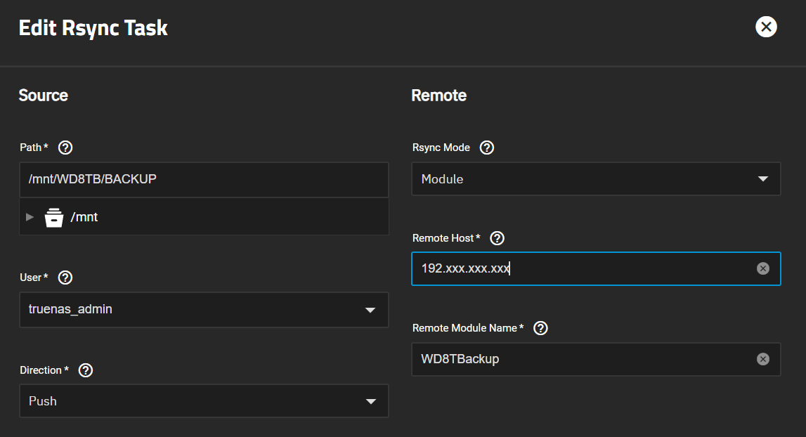

edit: so just for testing, i enabled the module and created a rsync task using the current TrueNas IP ( as remote )
However, i will run into
rsync: [sender] failed to connect to 192.xxx.xxx.xxx (192.xxx.xxx.xxx): Connection refused (111)
rsync error: error in socket IO (code 10) at clientserver.c(139) [sender=3.2.7]

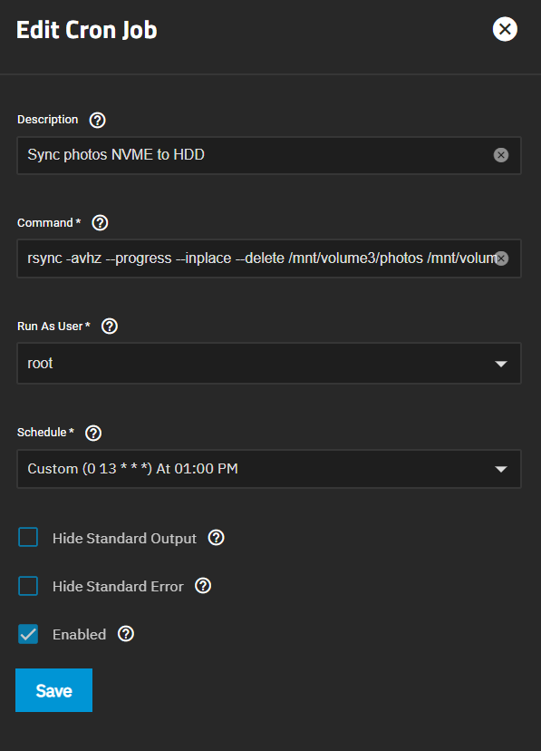

What I do is I run a cronjob that basically invokes rsync command.
@bugacha doing the same manually on CLI. Can you please show me how to create a cron for this.

this is a job for local dataset sync
rsync -avhz --progress --inplace --delete /mnt/volume3/photos /mnt/volume1/
