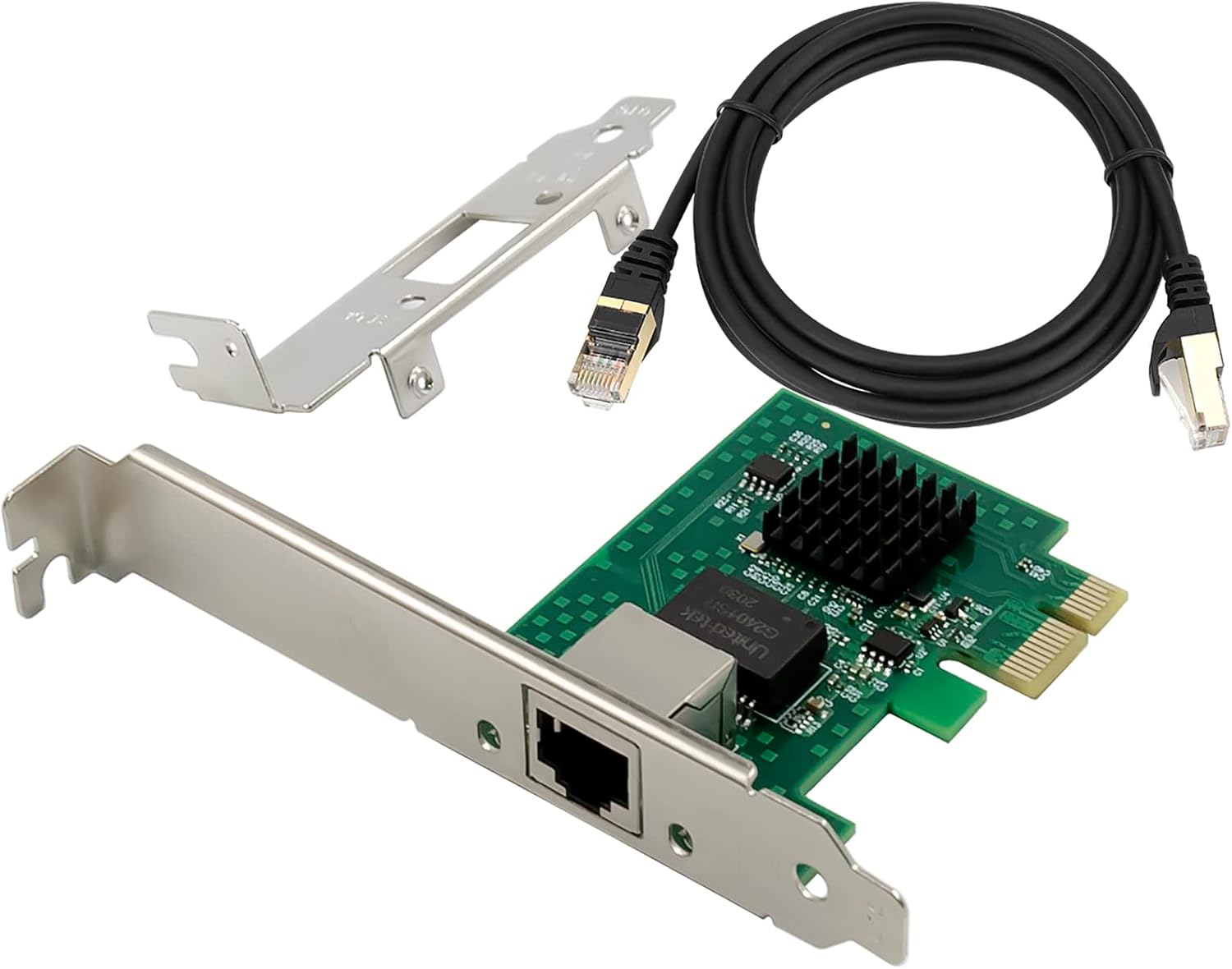

I came across your post mentioning that you installed an Intel network card on your HP n54l. I’m currently considering a similar upgrade and was curious, could you share which specific Intel card model you chose?
Also, I’d love to hear about your experience with the installation process and how it’s been performing so far (e.g., driver compatibility, throughput, stability, etc.). Any insights or recommendations would be greatly appreciated!
Thanks in advance!
This should be close to the card. I don’t know if you need low profile bracket or full height
https://www.intel.com/content/www/us/en/products/details/ethernet/gigabit-network-adapters/i226-network-adapters/products.html
This is the card I have fitted and it works well.
It comes with a low profile bracket which you will need to use.
