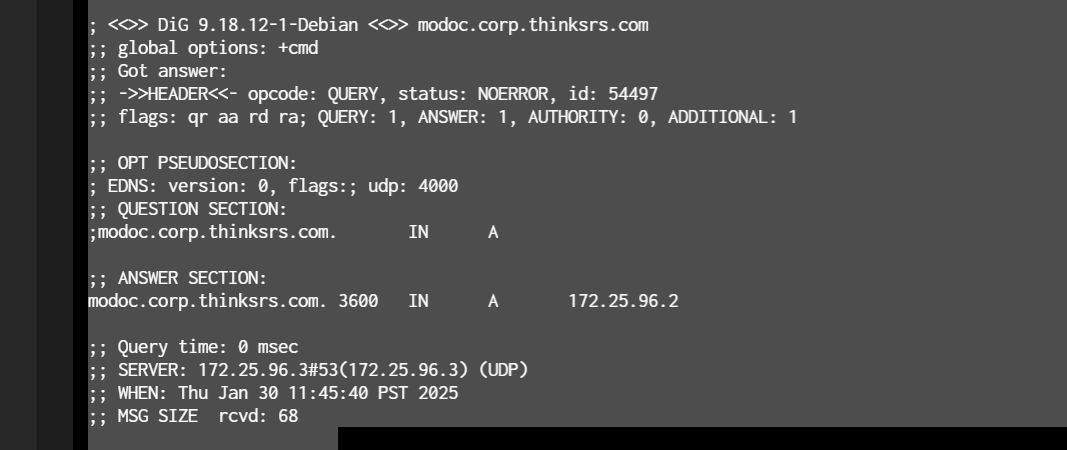

Can your TrueNAS resolve your AD servers with nslookup?
yes it can for both of them

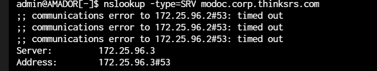

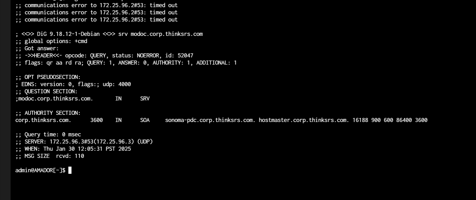

That’s an A record, not an SRV record. Try for instance to look up a kerberos record.
okay when i Nslookup SRV it cannot connect
