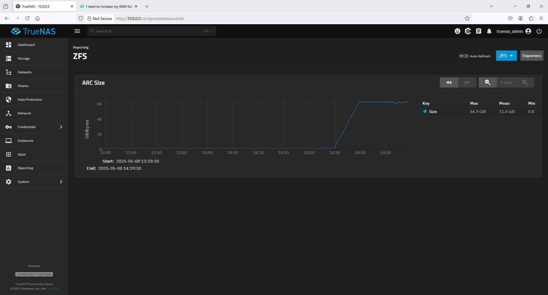

I restarted the transfer and the ARC seems to be holding steady at 57GB, and there’s 2-3GB not being used.
I was afraid the ARC would take more and run out.

I restarted the transfer and it looks like this after about 12 minutes.
That is absolutely what it is supposed to look like. What would you suggest the system do with that RAM instead?
Unused RAM is wasted RAM. If you add e.g. VMs to your configuration they will get their configured share of your physical memory but the ARC will always fill up the rest sooner or later. That is the point of a cache.
