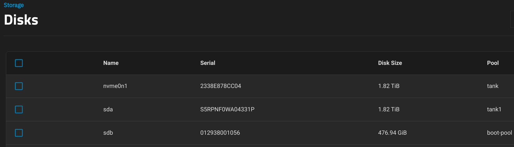

I’m new to Truenas and pretty much a newbie. I set up my system as follows:
GEEKOM A5 AMD Ryzen 7, 32GB RAM:
  • one 2TB SSD (Crucial P3 Plus M.2)
  • one 2TB Samsung 870 QVO SATA III
  • one 512GB NVME M.2 SSD (for the bootpool, usb-attached)
“tank1” is only for selected backups from “tank”.
(I know that the system isn’t ideal, but it is what it is for now)
The problem is that I ran out of storage space pretty quickly.
What can I do? The Geekom is at capacity, so the only option is to attach a USB disk. Can I plug in a USB disk and „expand“ my main pool?
If yes, which USB is preferable? Does it have to be an SSD?
I don’t want to make a mistake that later compromises the system.

At the moment you have no redundancy, so I can’t really recommend anything!!! You are currently already at the point where if any of the storage devices die, there will be data-loss!!
Mini-PCs are generally not great for storage capacity, and it seems you are at your limit - took a look and this device doesn’t have thunderbolt or an exposed PCIe slot so you are most likely out of luck.
