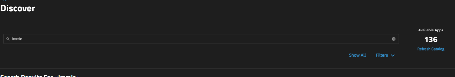

I assume you are installing from the catalog, not as a custom app. Have you tried refreshing the catalog before starting deployment?
