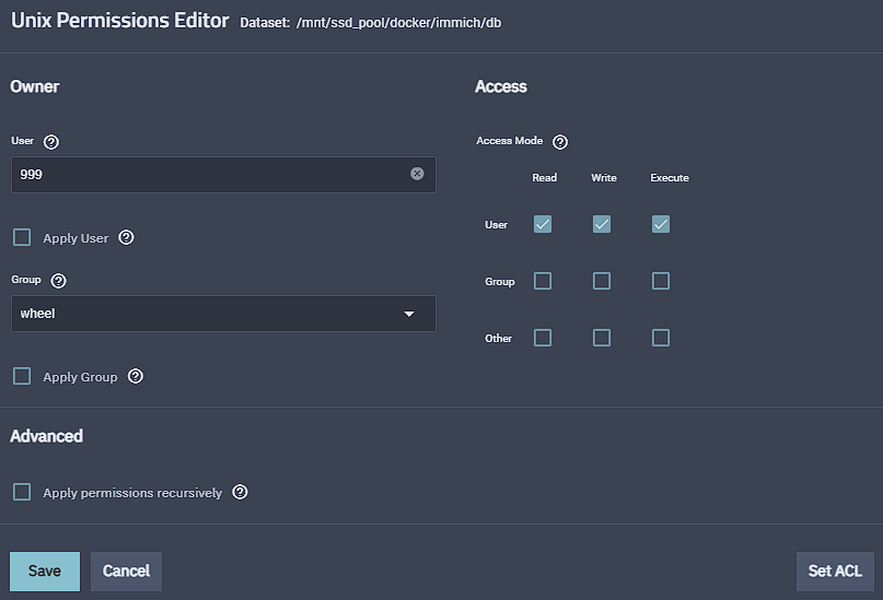

Postgress needs r/w permissions for user 999
I’ve allowed the user netdata that has 999 configured to change the folder but that didn’t help either. What should I do i my case?
Thx for your help!

I found as solution to my problem. Had to create all the folders as Generic and swap the root user with netdata (UID 999) which is needed for the DB to make changes.

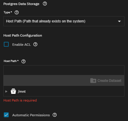

Glad you got it figured out. Alternatively, you can create a generic dataset for postgres and then use this Automatic Permissions checkbox when installing the app. Same applies for any app with a postgres storage location.
