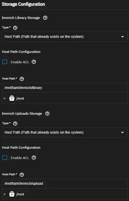

3.  Since creating the folders withing the IX systems folder does not work as intended i selected my own folders using the "host path" option so they mount the correct child datasets.

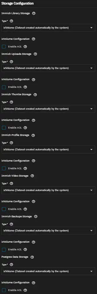

Below are immages of how i have this setup

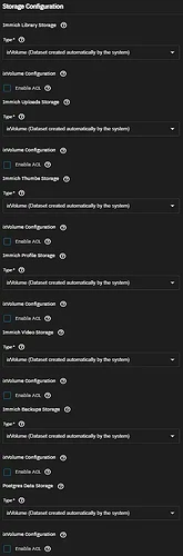

Here is what the page says I should configure…

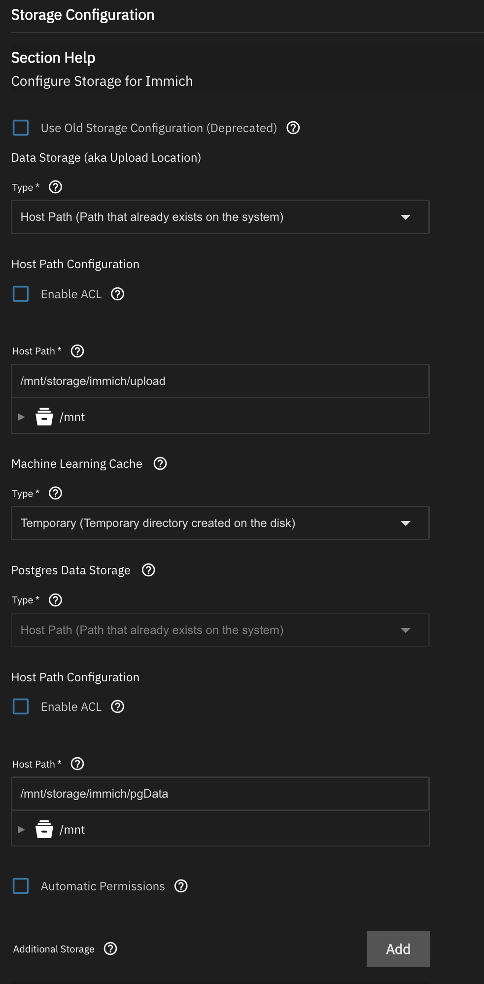

Here is what I am seeing…
For example, I don’t see an option to configure the path for Immich Uploads Storage as displayed in the documentation.
