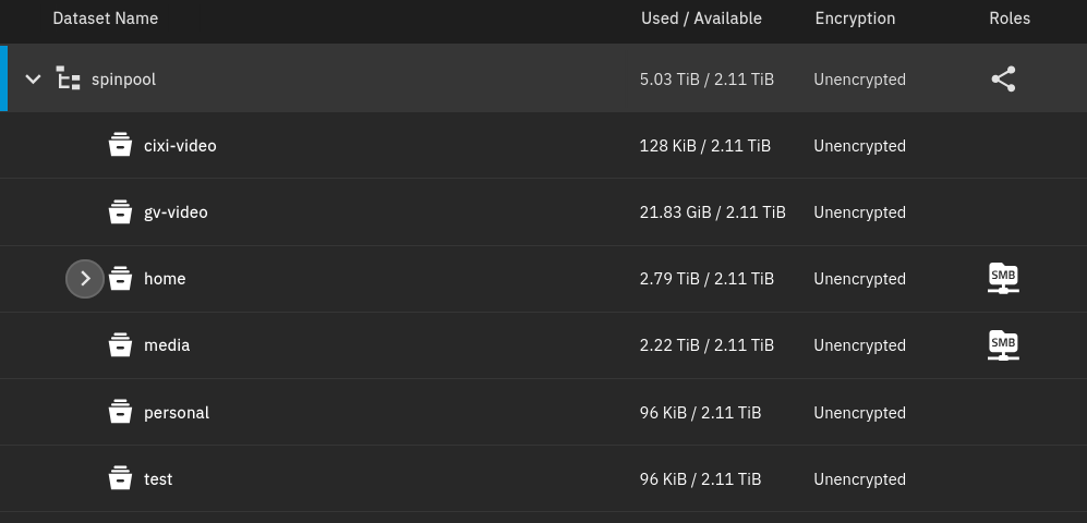

Can you describe your pool and datasets.
Are you sharing the pool directly… or a dataset?
The pool was created on FreeBSD 14.2 and then exported/imported into TrueNAS.
Only a couple of the datasets are used by Samba (a home-share for various users, and a media share)
