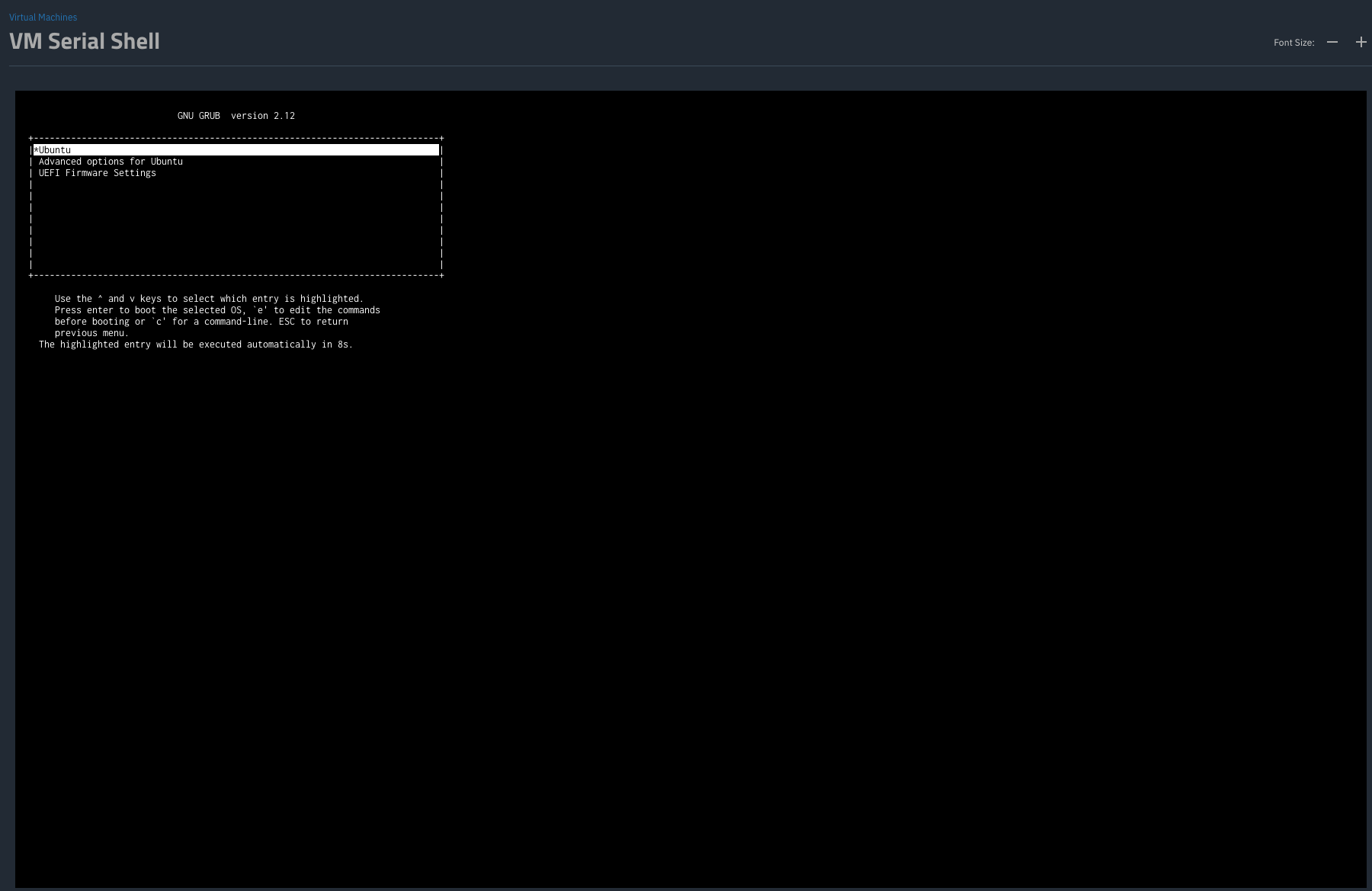

Lastly - As a temp solution I switched to serial console (options in GRUB) and removed display (VNC) device. I dont get quite all the startup “bios” and debian boot msgs. Any way to get those back on the (now) serial console?
I use Ubuntu but it’s probably the same or very similar.
  1. /etc/default/grub:
GRUB_TIMEOUT_STYLE=menu
GRUB_TIMEOUT=10
GRUB_CMDLINE_LINUX_DEFAULT=""
GRUB_CMDLINE_LINUX="console=ttyS0"
GRUB_TERMINAL=serial
sudo update-grub after saving.
  1. systemd
systemctl enable serial-getty@ttyS0
systemctl start serial-getty@ttyS0
That should do it.

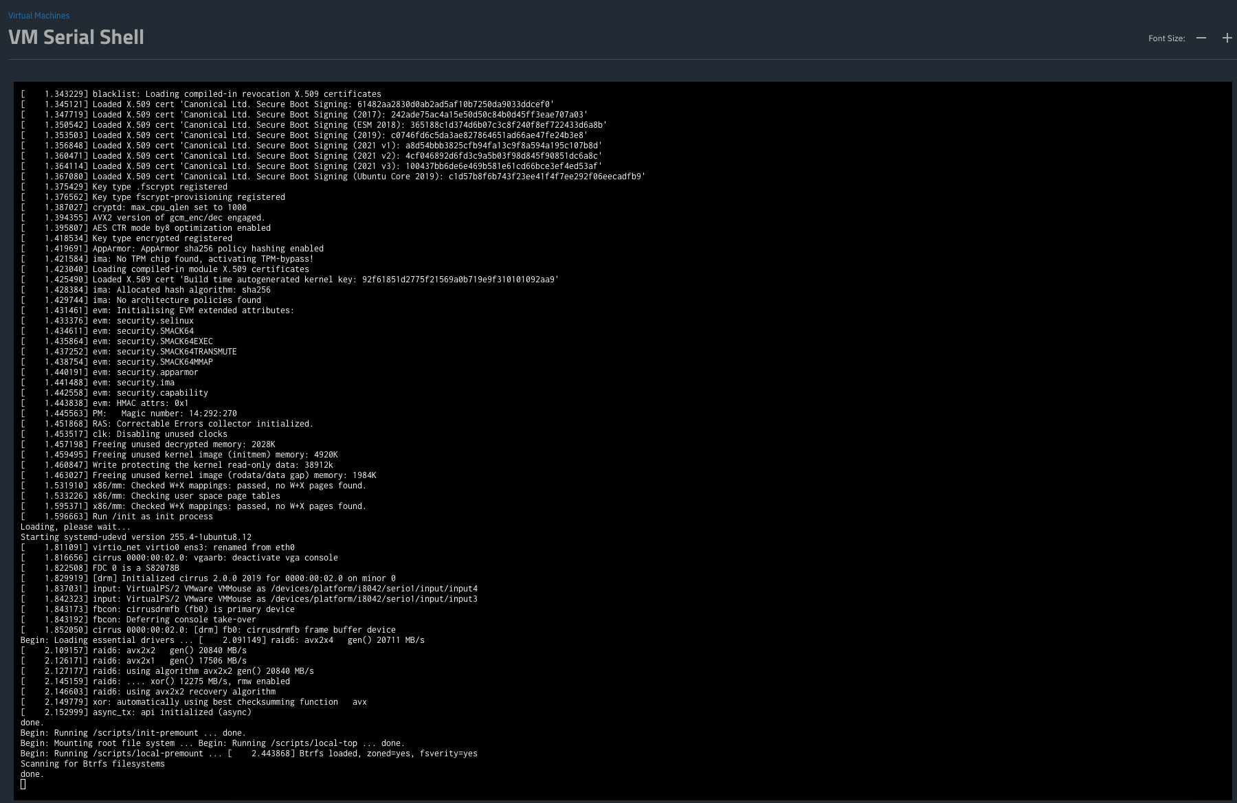

The standard directions I saw and followed mentioned adding the grub_cmdline_linux console=ttyS0, and enabling the ttyS0. That is what I did before. From your instructions, I changed grub_terminal as well, and now I do get the boot menu at the front. But it is followed by the same messages I got before, which are notably lacking the entire boot display I normally see on a machine.
After the boot menu (thanks!), I get just this….
____________________________
Booting `Debian GNU/Linux’
Loading Linux 6.12.63+deb13-amd64 …
Loading initial ramdisk …
/dev/vda2: clean, 41469/1802240 files, 575627/7206912 blocks
Debian GNU/Linux 13 pub ttyS0
pub login:
________________________________
Where did all the device probe and enumeration messages go, subsystem startup, etc.?
I realize this is out of scope for the original post, thanks so much for indulging!
I see all of them with the configuration as summarised above. Weird.
This part of the GRUB config should take care of that:

Embarassed, here’s why I wasn’t seeing them. The default grub config had this line:
GRUB_CMDLINE_LINUX_DEFAULT=“quiet”
Obviously, removing ‘quiet’ made all the wayward message appear. Sorry for missing that, and thanks so much for pointing me in the right direction!
