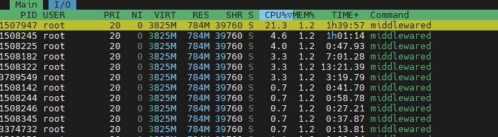

did by chance anyone notice the CPU usage of the middlewared service increasing by quite a margin (x2/x3) after you have used the GUI for a while ? I mean usually it sits around 1% and when you are navigating the GUI it of course goes up. But even after closing the GUI i had the middlewared service suddenly hogging 7-8% CPU constantly. And i am pretty sure none of the periodic tasks were running at the time:

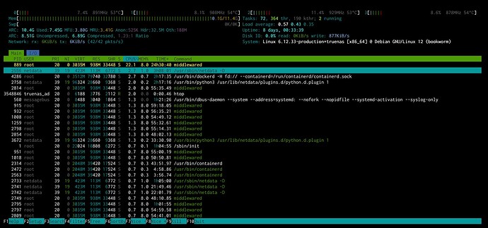

This is how middlewared behaves after 2 days - no workers doing anything, not logged into GUI:

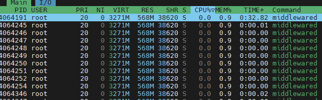

and this is how it behaves 10 minutes after a restart of the service:
You rarely see any cpu usage at all. Maybe i’m just interpreting things wrong, but it looks to me like some regression in the service…

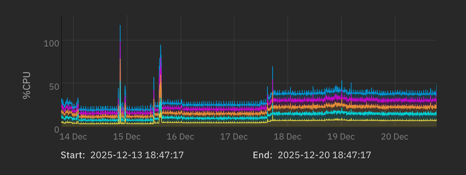

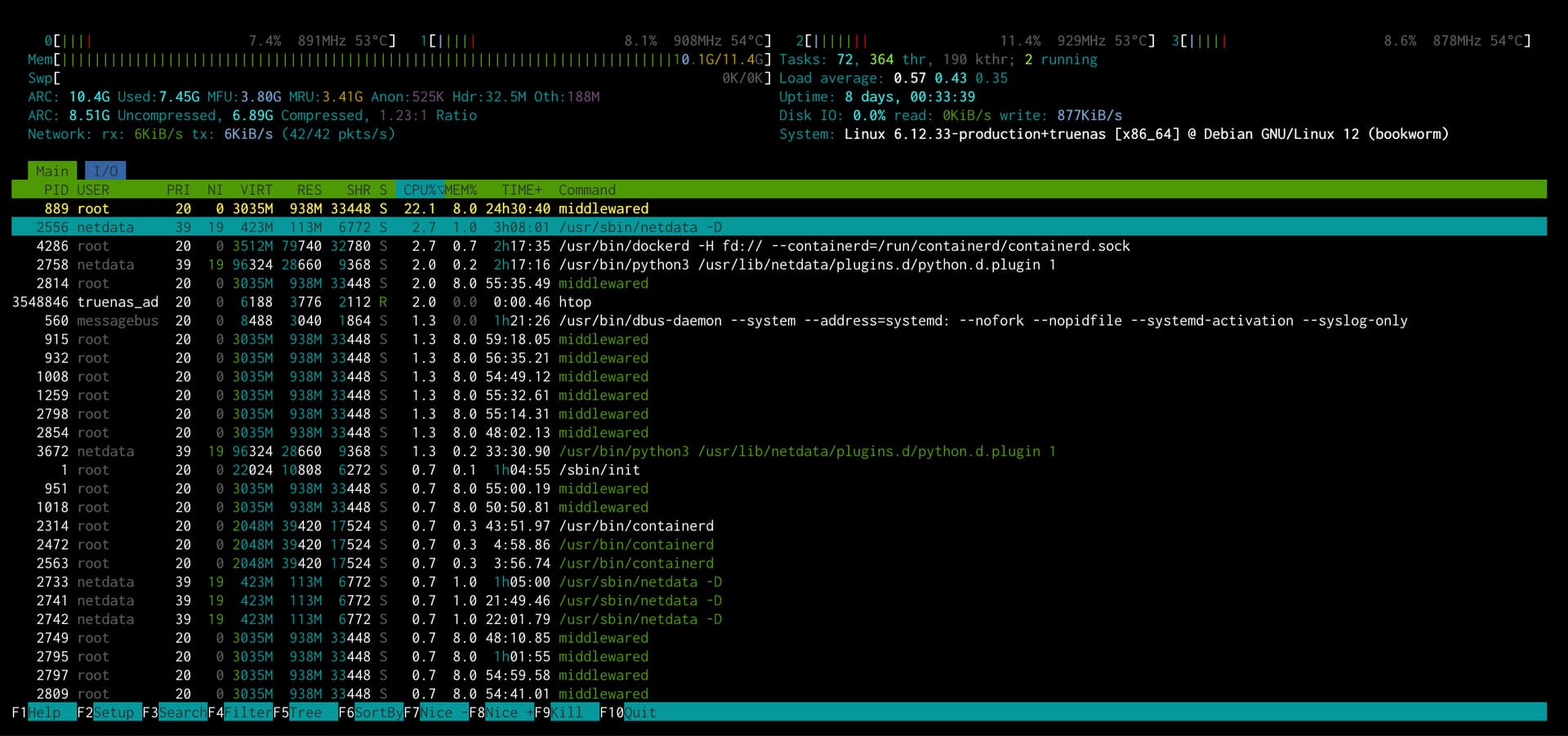

I’m observing the same thing in my TrueNAS 25.10.0.1 installation. It’s a new installation, around 10 days old. Runs three containers with minimal (i.e. 0%) CPU load. It’s not being actively used as a file server yet either. In fact, it has no shares yet.

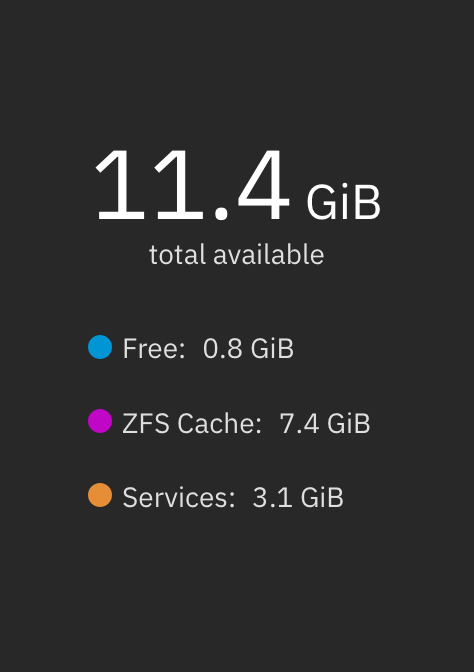

However, services’ memory use is slowly increasing despite sitting and doing nothing, and the CPU load is similarly increasing. It’s not a powerful server either. N150 with 12GB of RAM. I have attached some screenshots. I want to help with debugging and solving the issue.
Any guidance is appreciated.
Edit: Here are some snapshots from what I see.
My experience is similar. Gradual increase in memory usage clearly visible in the memory stats (TrueNas Scale GUI). I’m on 25.10.1.

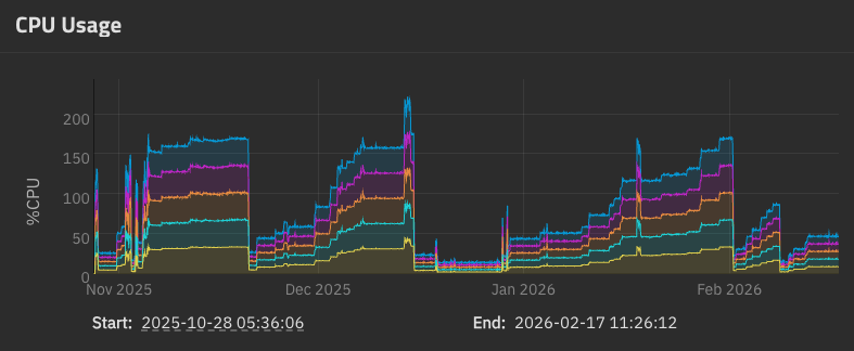

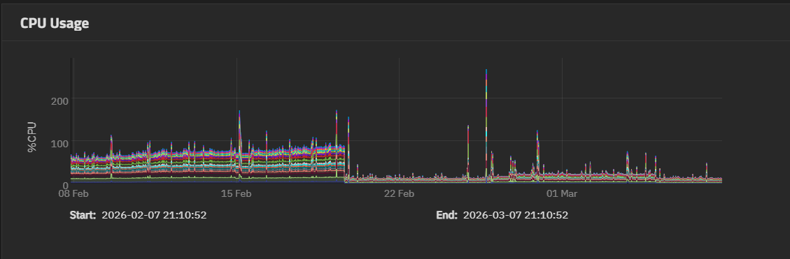

I believe 25.10.2 fixed the issue… this is my graph right now:
See the decrease? thats when i updated to 25.10.2
