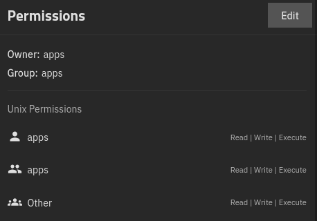

i have a dataset on the truenas host (25.04.1) /mnt/tank/configs permissions are:
there is a subdataset called test created with apps preset permissions:
Passing thru the hostpath
