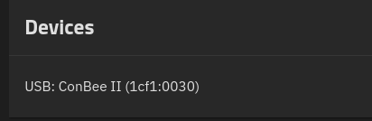

I was gonna say, I followed that link you posted and tried adding a USB device by busnum - devnum and it worked. Even shows up in the TrueNAS UI.
incus config device add HAOS-VM-TEST ZigbeeDongle usb busnum=001 devnum=009
The TrueNAS UI shows the vendor/product id
But incus config show reflects the desired options

(I was just testing the ConBee II again. It still doesn’t work)
If I add both manually using busnum and devnum, I get the same error in my first post on the GUI. I think for now I will just have to add by productid. It only shows the one device in the GUI, but at least they are both available in Home Assistant.
