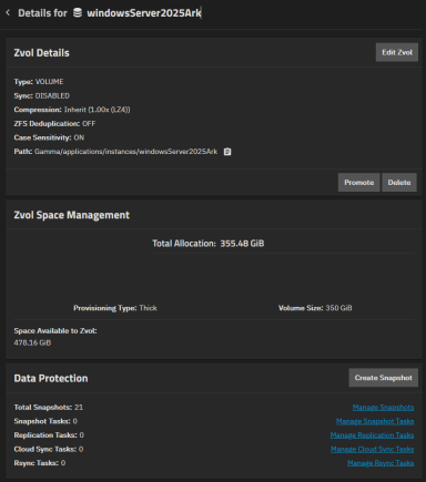

As said above I imported the Zvol then quickly realized upon running the windows server installer that the default 10 GiB root drive was still there and my imported Zvol did not replace it. I expected this, however what I did not expect was that when I selected my imported Zvol of 350 GiB for windows to install to, it installed successfully however TrueNAS doesn’t display that any space is being used in the Zvol (windows displays over 200 GiB being used by the C drive), in fact, it’s just blank as seen in the attached screenshot.
Upon seeing this I asked in the Discord about this behavior and a user instructed me that Incus simply copies the data from your imported Zvol to a hidden dataset rather than using it where it is.
This is concerning to me because I recently needed to access data from my replication task that was supposed to be replicating the snapshot data from the Zvol that I had assumed the Virtual Machine was using as its root disk, however to my surprise the replicated Zvol only had 105 KiB of data contained in the snapshots. The data was backed up elsewhere, however I would like to understand if my expectations of being able to store the actual virtual machine data on a Zvol of my choosing is flawed or somehow not the way Incus is intended to operate. And if it is the case that it’s possible to make Incus use my chosen Zvol as its installation location for the Windows Server, how do I do that? And if not, where is the location of my Virtual Machine data so that I can create a replication task for that location so I don’t have any more data loss.

Thank you for your post, I performed the steps outlined and the virtual machine booted successfully but now when I go to check in the “Datasets” tab and I navigate down to my instances dataset in which the Zvol I created was stored, it is now missing… Is this expected behavior?
I understand by performing this command
zfs rename Gamma/applications/instances/windowsServer2025Ark Gamma/.ix-virt/virtual-machines/windowsServer2025Ark.block
I am moving the location of the Zvol to where Incus expects the root devices to be, however my whole intention was to make Incus use the Zvol where I created it so that I can then create a replication task for my entire applications dataset, not copy the data from the Zvol and move it back into some Incus specific location.
If I am not mistaken this is practically the same issue I was running into before, the data is ultimately stored in a separate location managed by Incus that is independent from my Zvol, I never had any data from the VM in Gamma/applications/instances/windowsServer2025Ark to copy in the first place, I am creating a whole new VM.
Should I just create a replication task for Gamma/.ix-virt/virtual-machines/ for the time being if my goal is to have a replication task to backup snapshots of my virtual machines?
