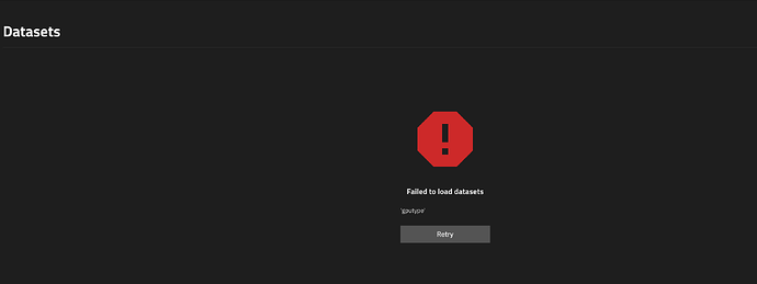

Incus VM cant add GPU via UI
When adding a GPU via the UI i get this error
middlewared.service_exception.ValidationErrors: [EINVAL]
device.GPU.gpu_type: Field required
using this works to add the device sudo incus config device add frigate gpu0 gpu pci=0000:0e:00.0 but breaks the UI with more validation errors, resulting in a broken device section showing nothing, i guess because its not setting gputype : physical ?
also it breaks looking at datasets if you add the gpu by hand to the incus container. ouch.
