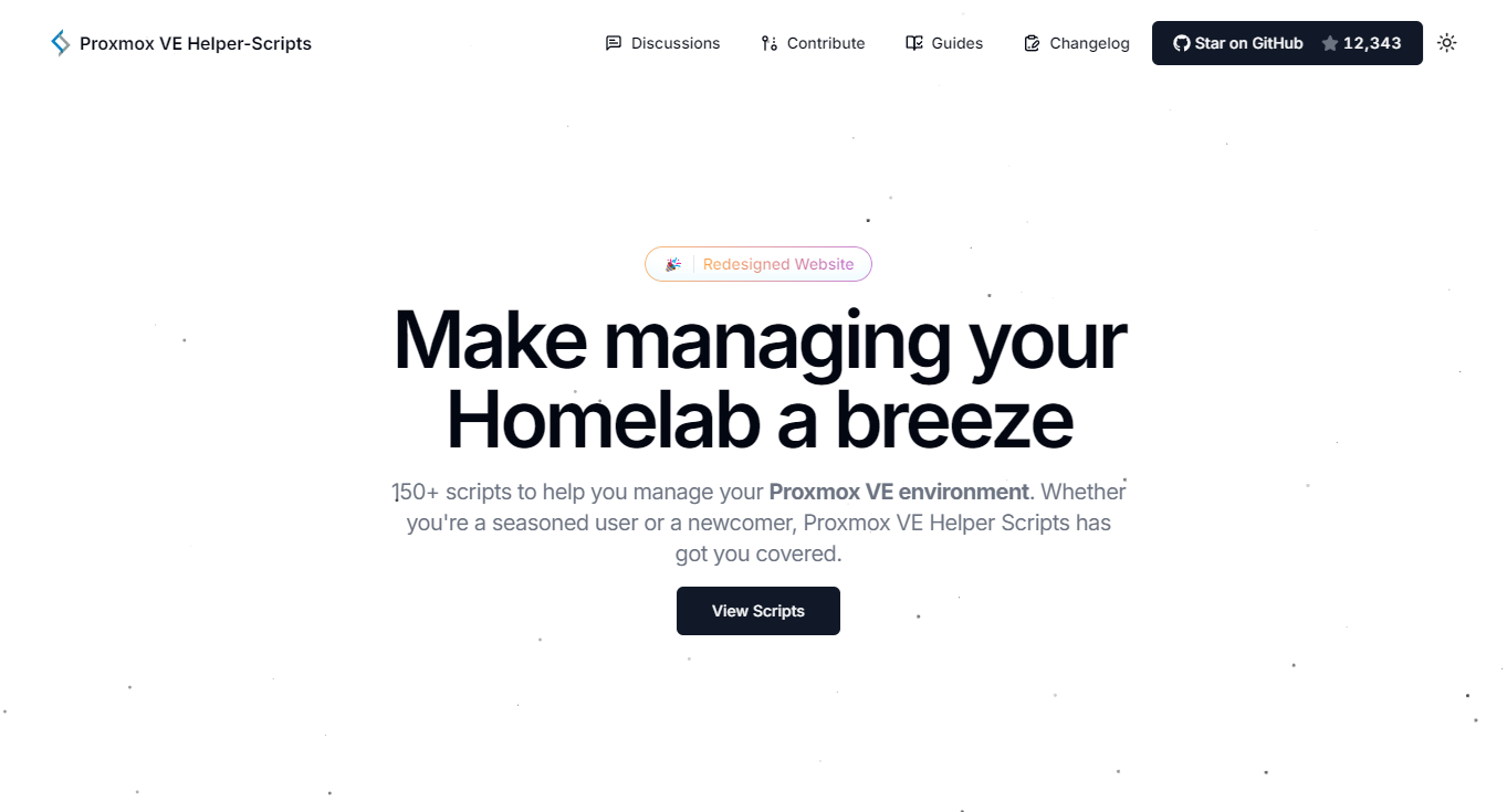

I love the Proxmox community scripts but Incus is my deployment method of choice, so I wrote a tool called surgeon to make surgical modifications of an upstream repository in a fork.
If you’re unfamiliar, the Proxmox community scripts give you a suite of over 200 scripts that create lxc containers or vms on Proxmox.
Thus IncusScripts was born.
It’s still early, but almost all of the “CONTAINER” scripts are working. So if you wanted to install a Ghost blog instance on your incus server, you could visit this url and copy the script to launch an instance.

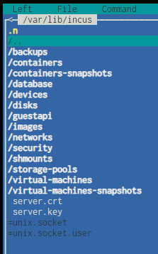

On second look, it doesnt seem to be all in .ix-virt.
Look at all the folders in /var/lib/incus/
Especially /database is important because that stores incus configs.
Looks like some of the folders are mounted to .ix-virt but not all
So in this case I would still worry about it breaking on upgrade.

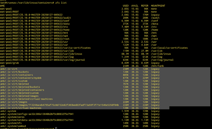

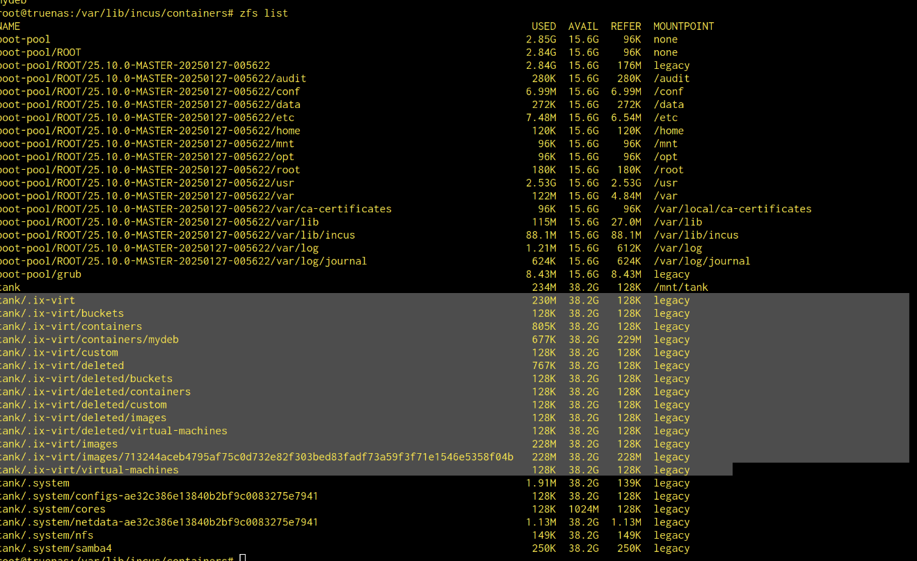

The issue is adding additional pools
The ix-virt dataset is where the default pool is stored. Each item is legacy mounted back into var/lib/incus on demand
