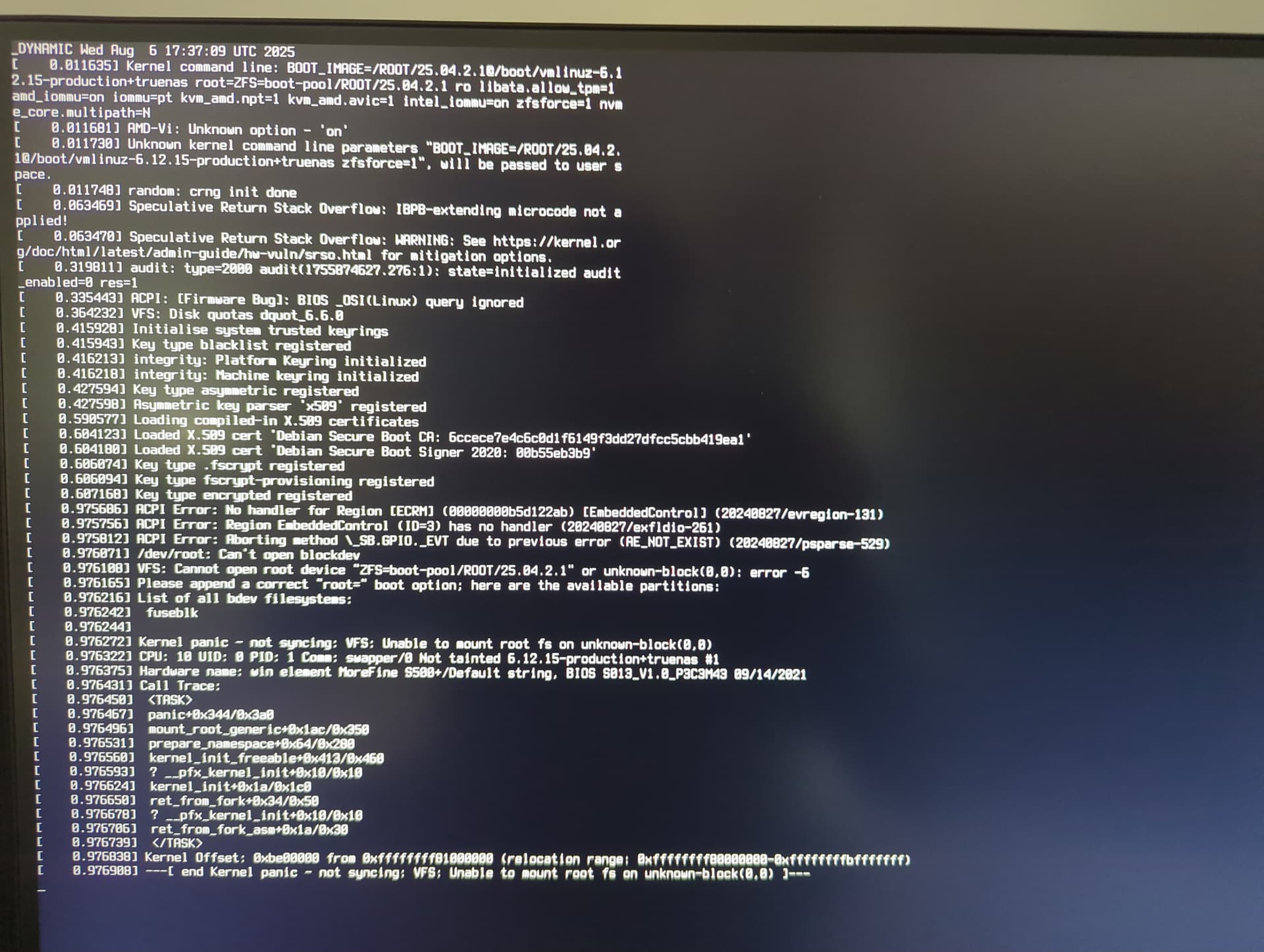

Continuing leads to “Kernel panic - not syncing: VFS: Unable to mount root fs on unknown-block(0,0)”

noticed the message about unknown AMD-Vi option in my “screenshot” and went spelunking in the bios. found “AMD CBS” → “NBIO COMMON” → “IOMMU” and changed it from “[AUTO]” to “[ENABLED]”.
tried installing 25.04.2 after removing the new pcie card, same error occured for the regular boot option. However, the advanced boot option worked. (i never tried that with 25.04.2.1)

looking at the grub config in /boot/grub/grub.cfg the only difference between the default and advanced option seems to be the image used (production vs debug)
default option fails:
echo ‘Loading Linux 6.12.15-production+truenas …’
linux /ROOT/25.04.2@/boot/vmlinuz-6.12.15-production+truenas root=ZFS=boot-pool/ROOT/25.04.2 ro libata.allow_tpm=1 amd_iommu=on iommu=pt kvm_amd.npt=1 kvm_amd.avic=1 intel_iommu=on zfsforce=1 nvme_core.multipath=N
echo ‘Loading initial ramdisk …’
initrd /ROOT/25.04.2@/boot/initrd.img-6.12.15-production+truenas
advanced option working:
echo ‘Loading Linux 6.12.15-debug+truenas …’
linux /ROOT/25.04.2@/boot/vmlinuz-6.12.15-debug+truenas root=ZFS=boot-pool/ROOT/25.04.2 ro libata.allow_tpm=1 amd_iommu=on iommu=pt kvm_amd.npt=1 kvm_amd.avic=1 intel_iommu=on zfsforce=1 nvme_core.multipath=N
initrd /ROOT/25.04.2@/boot/initrd.img-6.12.15-debug+truenas
