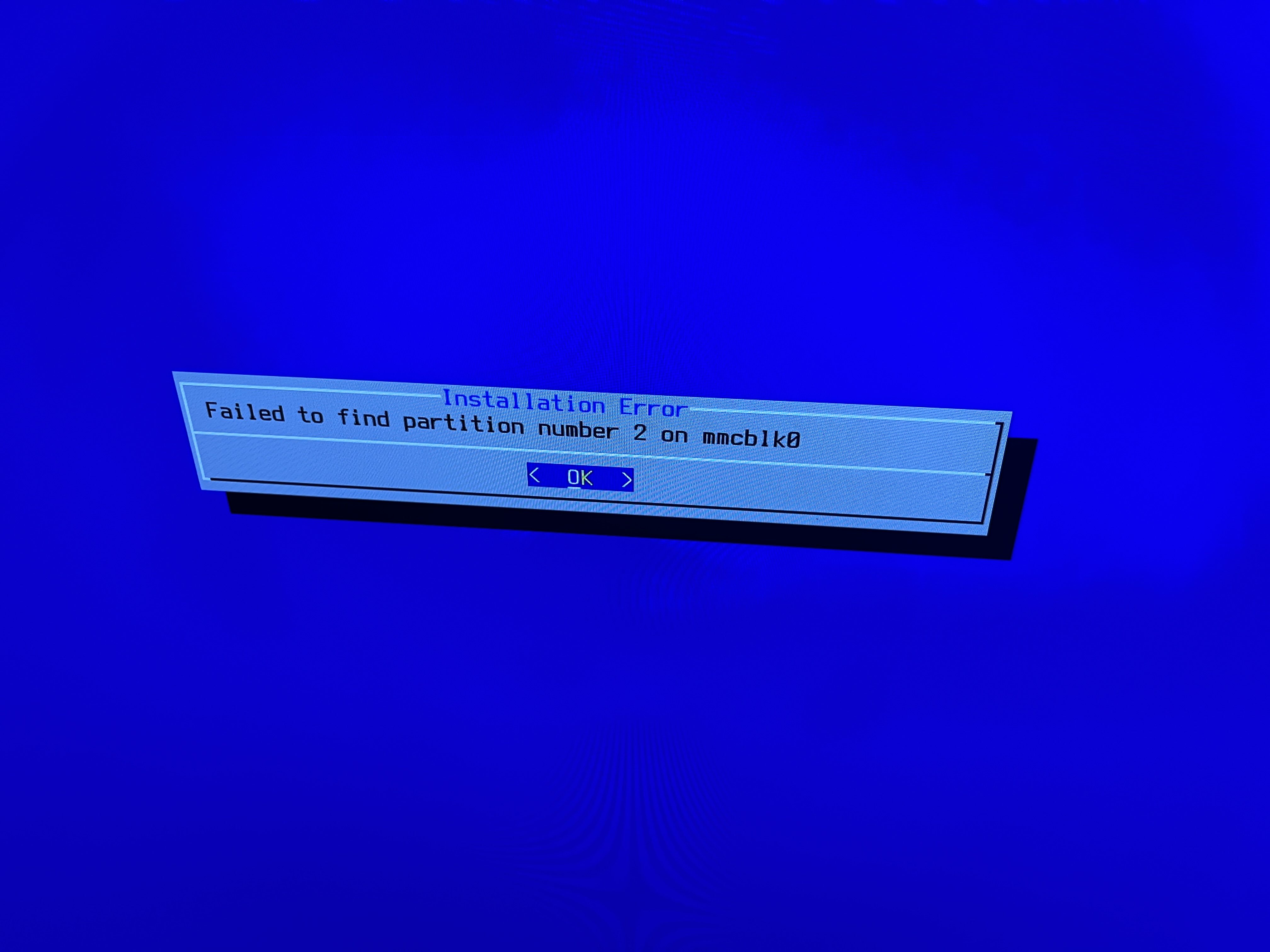

Device: UGREEN DXP2800
Error Experienced: Failed to find partition number 2 on mmcblk0
At this point I am assuming that you’ve already successfully created your boot disk, and have attempted to install truenas scale on your DXP2800.

I had the same issue when installing 25.04.
“Failed to find partition number 2 on mmcblk0”
I had an older version on hand and it installed successfully (23.10). So there seems to be a regression in the install script between 25.04 and 23.10, possibly 24.x versions.
