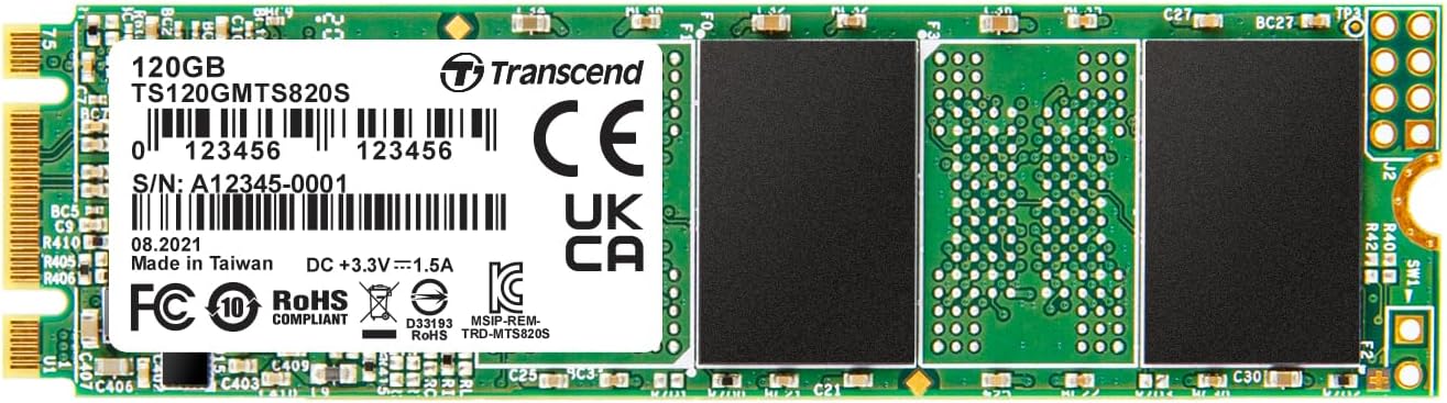

Thanks for the update here. I just ordered a DXP2800 and have been debating about whether to install the OS on an m.2 or use the emmc. Seems like finding an m.2 with less than 500GB is impossible and I hate to use such a big drive for just the OS. I’ve seen people partition it but it seems like it’s discouraged so I was kind of leaning towards using emmc, in which case it looks like I should use 24.04.5.
It’s hard to say without knowing where you are, but:
https://www.amazon.com/Silicon-Power-128GB-P34A60-SP128GBP34A60M28
Not hard to find at all, at least in .us.

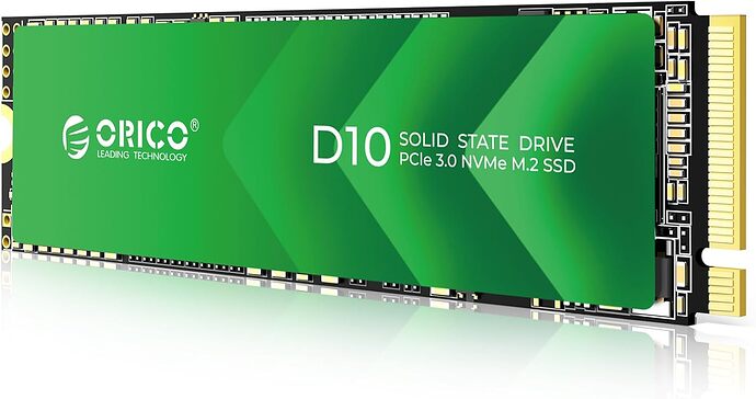

I have the orico ones in a 4800 I just got.
