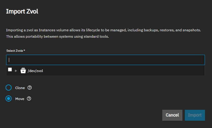

You likely selected Move instead of Clone.
ah, so that wasn’t so clear. So if I clone it, then the hidden .ix-virt volume becomes the active volume and the existing HAOS zvol replicates and serves as a backup?
So, this is something that has changed between RC and the release.
I don’t understand why we now have to clone or move the zvol to use it. I already have it set up in the location I want it to be. Why can’t we just select and use the zvol as before? Obviously, I don’t understand why this change was required. Can someone please explain?
Does this get rid of the extra root drive that is being created? Or is the clone going to the root drive instead of having an empty root and a zvol attached?
It didn’t work like this in the RC - I have (well I had) a similar setup. I don’t understand why we can’t just set up our NAS with stuff where we want it to be. Why does stuff need to be manipulated and moved around? Is it really that hard to let us manage our own data locations. I was looking forward to eventually moving my primary HAOS back to TrueNAS, but not so much anymore.
My understanding of this, and I’m not a developer so that is second-hand, is that there were some significant performance issues with mounted zvols discovered in the early release versions, so that is part of the motivation. The other purpose, which is indicated in the UI help text, is to allow Incus to fully manage the instance volumes, which in turn exposes them for Incus’s native backup/restore and snapshot functionality.
Work is in progress to expose these features in the UI.
Currently it does not, but I believe there is also development work in progress to allow you to select a volume and then make it the root disk or move it to the root disk at least, so an additional volume mount will not be needed.

When I update this guide, do you think it would be better to suggest a clone or move when importing the zvol?
My guess would be clone is more useful for people trying it out, since that allows for easier roll back to the 24.10 boot environment if needed.

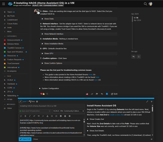

I’m unable to create a VM in 25.04.2, and the system is saying “Can not retrieve response” (as per screenshot).
Background:
I’m currently running haos in an “Instance”, having migrated the previous Electric Eel VM zvol to an instance when Fangtooth was released. I moved the original zvol, rather than clone it (a mistake in hindsight, since I now have to remake an haos zvol - not difficult, but still…).
So: I’m now trying to recreate a ‘classic’ VM in 25.04.2 using the VM name ‘haos’, according to the guide posted above. I’ve downloaded the image, written it to my 50GB zvol, set up the zvol/CPU/RAM/networking all as per the guide.
But when I hit the final “Next” to actually create the VM, a drop down box appears saying “Virtual machine created” with a green tick - but nothing appears on the UI (again, as attached).
I’ve tried clearing the browser cache, reloaded the page AND restarted TrueNAS.
Interestingly, when I try again to recreate the vm, using the same name ‘haos’ TrueNAS says “the name “haos” is already in use”. I’ve also tried creating the vm with a range of new / different names, still no avail, but whenever I re-use the name of a vm I’ve just tried to create, the same “[name] is already in use” error is shown, so something must be saving somewhere, but nothing in the GUI.

EDIT: My issue with VM is now solved - it was a TrueNAS bug:
Surprisingly, I seem to be able to edit the OP’s post, which poses a security risk. Perhaps the community administrator needs to check the backend permission configuration.
I was busy for a while and not able to update the post in a timely manner so I had made it a wiki.
