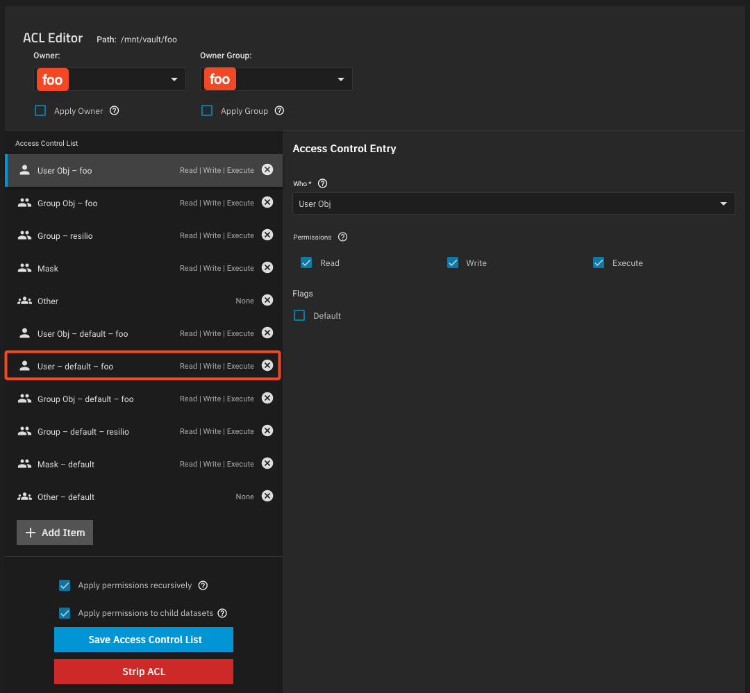

  2. Fixing the ACL on the Dataset:
    To solve this, I manually changed the ACL of the dataset “foo” to include an ACL entry for user foo with the default flag enabled. The steps were:
    1. Edit the ACL on dataset foo.
    2. Add an item:
      • Who: User
      • User: foo
      • Permissions: Check Read, Write, and Execute
      • Enable Default Flag: checked
    3. Apply permissions recursively.
    4. When prompted, confirm the popup warning, then apply permissions to child datasets.
    5. Save the Access Control List.
    Image of what the ACL look like after all the changes
    This ensures that even when Resilio creates or modifies files, foo still gets an ACL entry (inherited with default flags) granting full access.

I just followed 99% of these instructions and it worked out perfectly! I’m familiar with Linux and POSIX ACL’s but this is my first time in TrueNAS and working with NFSv4 ACL’s and containers. I got a little lost with multiple things named “foo” in your example, but it ended up working in the end since I made the owner and group “resilio” (ID 3001).
I have one question: I made my dataset using the Apps preset which uses NFSv4 ACL’s and your writeup calls for adding read/write/execute and enabling the default flag. Would you happen to know what the NFSv4 equivelant would be?
The available options are:
Premissions: Read Data, Write Data, Append Data, Read Named Attributes, Write Named Attributes, Execute, Delete Children, Read Attributes, Write Attributes, Delete, Read ACL, Write ACL, Write Owner, Synchronize.
Flags: File Inherit, Directory Inherit, No Propagate Inherit, Inherit Only, Inherited
If I have to convert to a POSIX, that wouldn’t be the worst thing.
In any case, thanks for the great writeup!
-K
Glad to hear @krhainos ! I don’t use NFSv4, only SMBv3, because SMB provides better performance on my macOS and is also more compatible with Windows machines.
I’m not entirely sure if this is considered best practice on Unix, but in the Windows world, you typically set ACLs on the filesystem and then configure the share to grant “Everyone” full control. This approach makes troubleshooting much easier later on. That’s why I set all my SMB shares to “everyone@ - FULL - Allowed.”
Even if you use NFSv4 for shares, it doesn’t affect the filesystem ACLs on your datasets. Everything remains as I described in my post. I hope I understood your question correctly.
Hi patCH,
I’m all-SMBv3 here too. It’s not so much which protocol used to share the datasets, but which type of ACL chose configured for the dataset (POSIX-type or NFSv4-type). The permissions/flags options offered are different depending on which one was picked.
I’m not familiar with NFSv4 ACL’s, and wondered if you knew off-hand what the NFSv4 equivalent of the POSIX options you had picked were.
