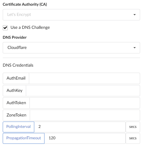

Now, I’m having configuration issues with the ACME Tool to generate Let’s Encrypt certificates. I’m using Cloudflare as my DNS provider. I see the following screen:
Now, based upon some guessing and looking at other configurations (DDNS Updater), I’m guessing the following:
  • AuthEmail - This is my login email at CloudFlare
  • AuthKey - I thought this was my Cloudflare Account ID
  • AuthToken - I thought this was my CloudFlare API Token with the Edit zone DNS privilege
  • ZoneToken - I thought this was my Zone ID
Somehow, it isn’t working. I ran out of tries and am on a three-hour timeout, so looking for suggestions.
Okay, figured this one out after some more searching…
  • AuthKey - Leave blank
  • AuthToken - CloudFlare API Token with the Edit zone DNS privilege
  • ZoneToken - Leave blank

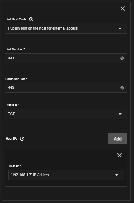

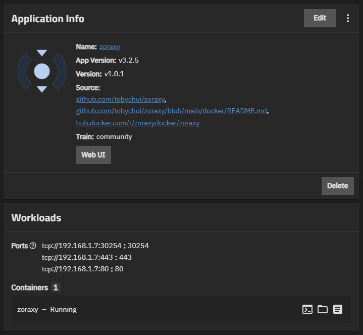

It turns out that several port mappings have to be created in the networking section.
This should give you this:

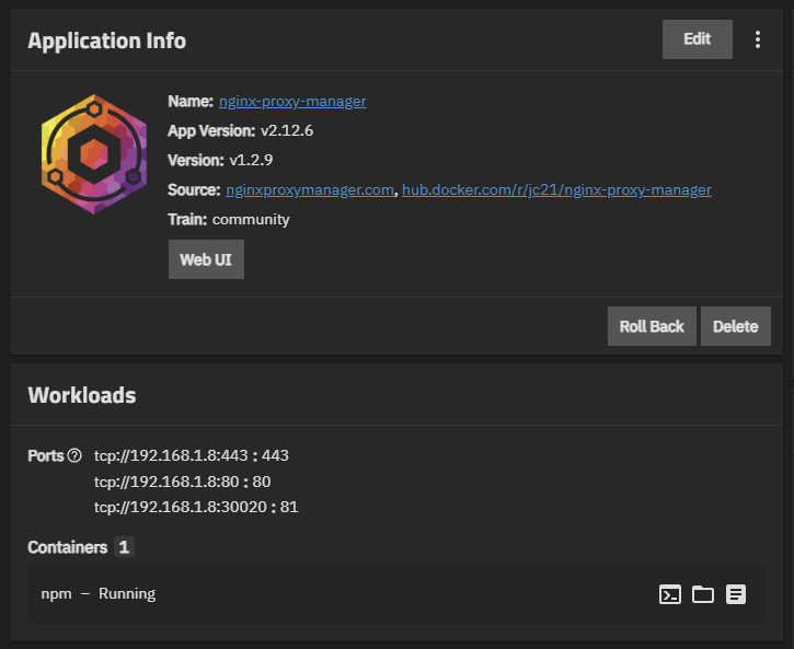

Which matches up with the working Nginx Proxy Manager:
