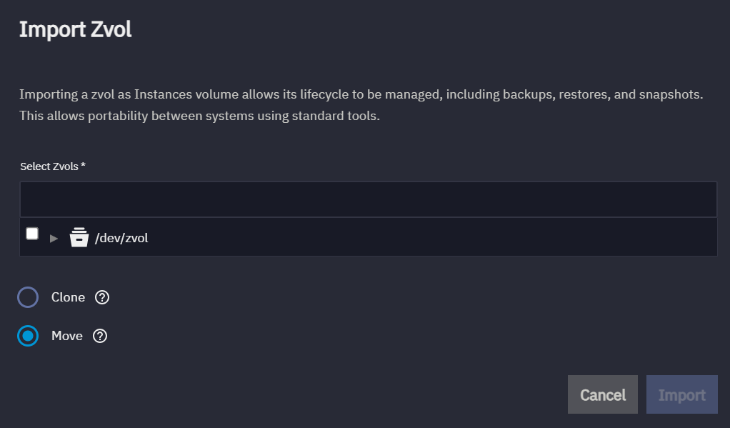

Under the “Import Zvol” menu, it says “Importing a zvol as Instances volume allows its lifecycle to be managed, including backups, restores, and snapshots. This allows portability between systems using standard tools.”
However, I cannot figure out how to actually perform backups, restores, and snapshots for Instance volumes through the GUI - I think it would be possible from the command line, but I generally like to stick to the GUI for such tasks. Is this functionality actually shipped with 25.04, or is planned for a later release?

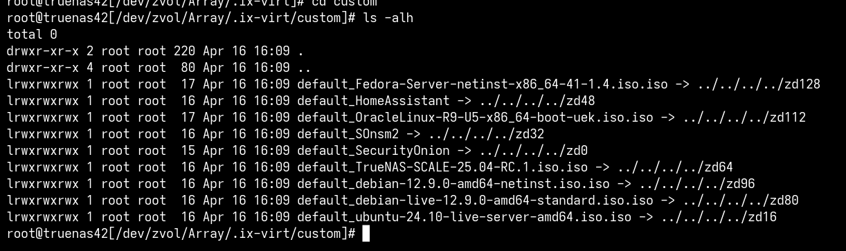

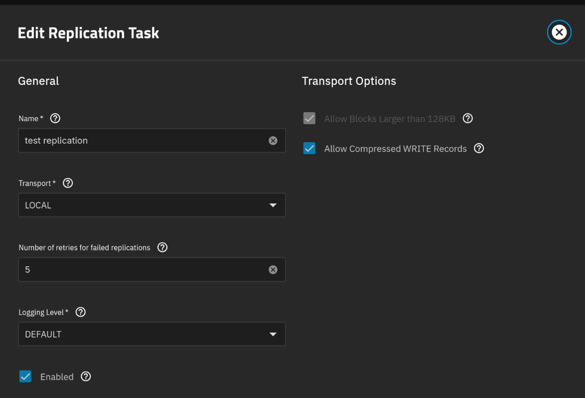

I found the directory where the zvols are stored, do with this information what you will. :stuck_out_tongue_closed_eyes:

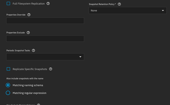

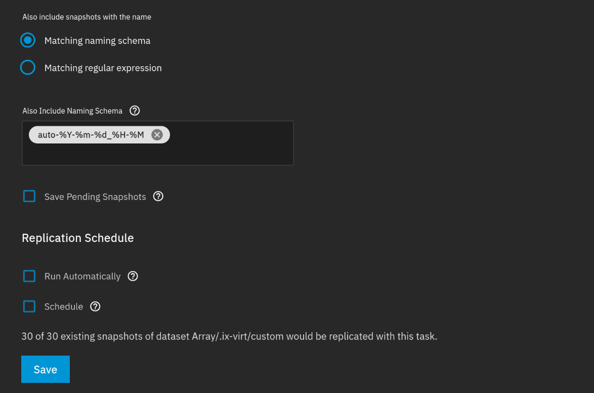

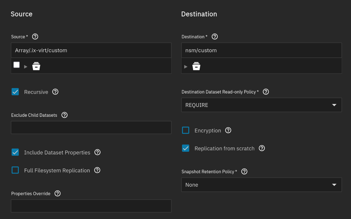

I setup a replication task in the UI from MYPOOL/.ix-virt/custom to BACKUPPOOL/custom with recursive checked and it seems to be doing the thing. Now I just need to tweak and fiddle with replication jobs until I get back to where I was before.
Importing allows Incus to manage the volumes, allowing access to it’s native backup tools. There is currently no UI support for the backup features, but it is being worked on.
You may be able to use Incus commands to manage this via the command line, but I don’t have any experience with it.

Weird, I tried to do this but it didn’t work at all. Tried going through the Replication Task Wizard and it just stalled out after I hit “Save” :frowning:
I went to the Advanced setup, I’ve not had good luck with the wizard.

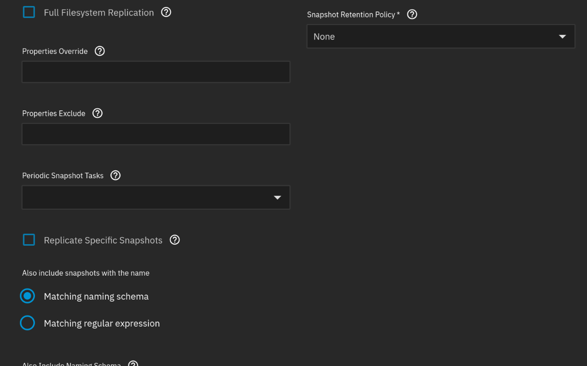

This is the settings that worked for me in the advanced setup.
