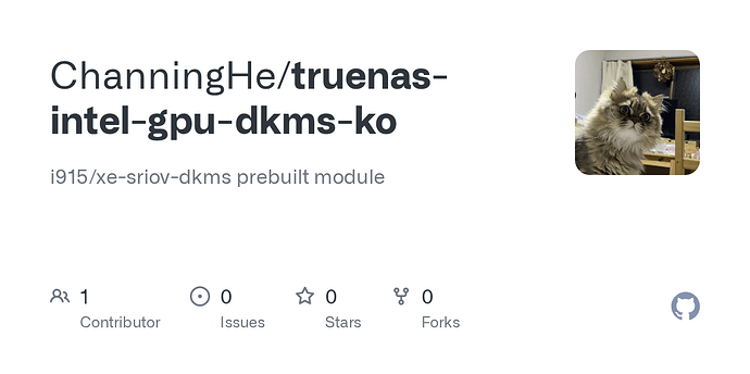

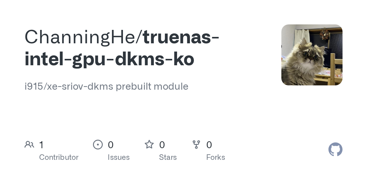

However, since the official kernel hasn’t yet included 6.17 support, I built and extracted the modules to avoid running install-dev-tools after every update and to quickly restore all services. I’ve uploaded them to GitHub, along with some additional details.
So, only a few steps remain:
# Download the kernel .ko files
KOVERSION=20251010
mkdir ./kofiles
wget -O ./kofiles/xe.ko \
  https://github.com/ChanningHe/truenas-intel-gpu-dkms-ko/raw/refs/heads/main/kofiles-${KOVERSION}/xe.ko
wget -O ./kofiles/intel_sriov_compat.ko \
  https://github.com/ChanningHe/truenas-intel-gpu-dkms-ko/raw/refs/heads/main/kofiles-${KOVERSION}/intel_sriov_compat.ko
# Disable readonly
zfs set readonly=off "$(zfs list -H -o name /usr)"
# Copy the .ko files
mkdir -p /lib/modules/$(uname -r)/updates/dkms/
cp ./kofiles/*.ko /lib/modules/$(uname -r)/updates/dkms/
# Update module dependencies
depmod -a
Make sure your .ko files are under /lib/modules/$(uname -r)/updates/dkms/

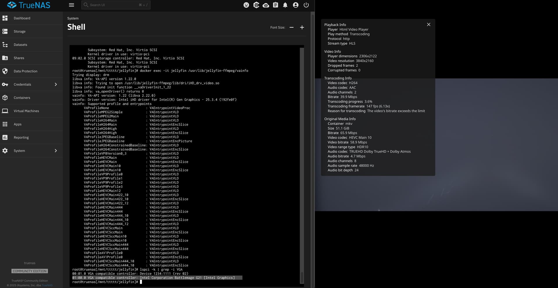

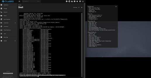

And if /dev/dri/renderD128 appears, it means the driver has been successfully initialized.
root@truenas[~]# ls /dev/dri
by-path  card0  card1  renderD128
In my case, the kernel shows some error messages, but Jellyfin still works great!

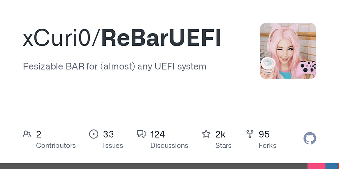

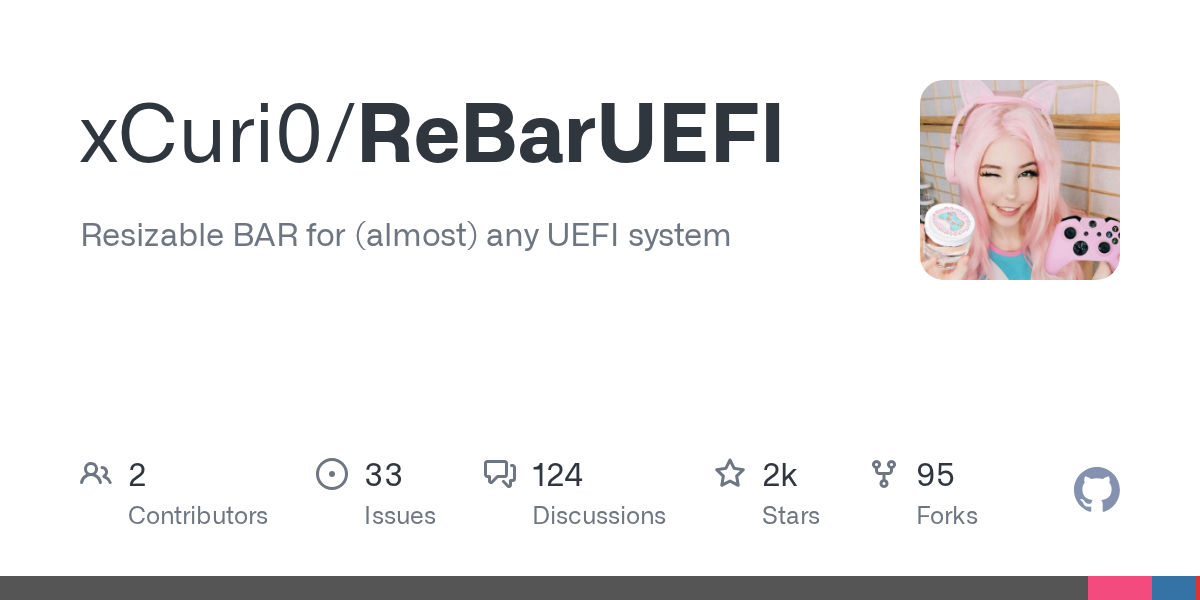

For systems where the BIOS doesn’t expose a ReBAR option, this project is very helpful:
You can inject ReBAR support via a UEFI module quite easily. I’ve used this method on platforms that don’t natively support ReBAR, and after enabling it, Battlemage cards work fine for transcoding as well.
