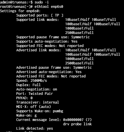

Thanks for your reply. I did that, ran the command and it completed without error however when I ran the ethtool //interface name// command this is what came up (notice auto neg is still on):
Any change if you just try to ethtool //interface// autoneg off?
If not then next thing I would try (don’t do this if it is your only way to connect to the server; see physical access or ipmi) is to shut the interface, try ethtool, then bring the interface back up. Beyond that, I’m out of ideas
ip link set /interface/ down' 'ethtool etc. etc.
`ip link set /interface/ up’
