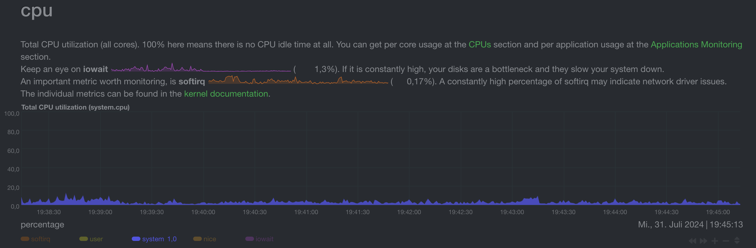

to give a little context, this was the system cpu usage before the fix was applied:
and this is the usage after:
