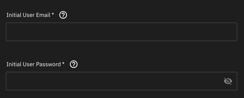

I have it deployed on my home NAS, using the app deployment from the catalog, any specific settings you need clarifying? I just set the 3 passwords, the app key, user email and password and it deploys without an issue.
Just installed it to test and had the same experience. The tooltip says the app key needs to be exactly 32 characters; if that’s accurate it could account for a problem. Otherwise, what issues were/are you having?
I did the same. set the needed passwords and all. I think perhaps it is the app key. Not knowing how to get one, I created one. I’m guessing that was wrong? How do I create the app key?
I also didn’t set an email and password. Is that required?
