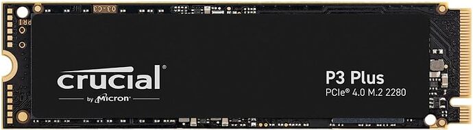

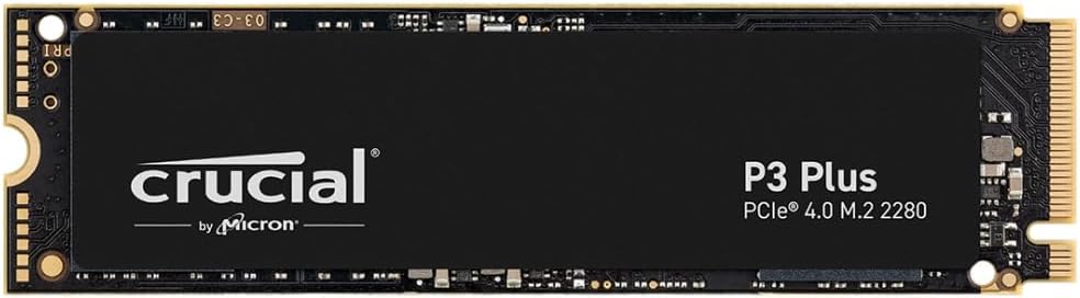

This drive costs $60 chosen at random and delivers 5GB/s reads. That would require a 100gb ethernet fiber network.
