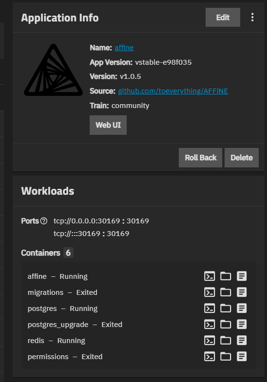

So my case is:
  • I have an Affine docker container that works generally fine in the browser with <truenashost>:30169
  • When accessing it through Nginx Proxy Manager I noticed a lot of errors

This is from the TrueNAS Scale Host if that helps:
sudo docker network inspect bridge
        "Name": "bridge",
        "Id": ".....",
        "Created": "2025-07-06T21:47:58.688103......",
        "Scope": "local",
        "Driver": "bridge",
        "EnableIPv6": true,
        "IPAM": {
            "Driver": "default",
            "Options": null,
            "Config": [
                    "Subnet": "fdd0::/64"
                    "Subnet": "172.16.0.0/24",
                    "Gateway": "172.16.0.1"
        "Internal": false,
        "Attachable": false,
        "Ingress": false,
        "ConfigFrom": {
            "Network": ""
        "ConfigOnly": false,
        "Containers": {},
        "Options": {
            "com.docker.network.bridge.default_bridge": "true",
            "com.docker.network.bridge.enable_icc": "true",
            "com.docker.network.bridge.enable_ip_masquerade": "true",
            "com.docker.network.bridge.host_binding_ipv4": "0.0.0.0",
            "com.docker.network.bridge.name": "docker0",
            "com.docker.network.driver.mtu": "1500"
        "Labels": {}
Also forcing Nginx Proxy Manager to use IPv4 by entering the IP instead of <truenashost> fixed the issue in the container for now.
