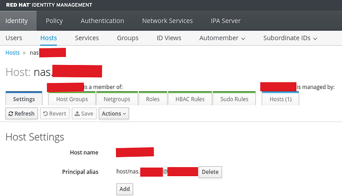

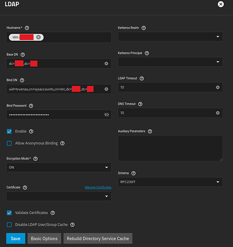

Hello again. I’ve been holding out for 24.10.2, but have now updated and am back to trying to get LDAPS working. I did get TrueNAS to connect to my RHEL IdM server (FreeIPA), but get this warning:
Attempt to fully join IPA domain failed. TrueNAS will continue to act as an IPA client but with diminished capabilities including lack of support for kerberos security for NFS and SMB protocols. [KRB5KDC_ERR_C_PRINCIPAL_UNKNOWN] Major (458752): No credentials were supplied, or the credentials were unavailable or inaccessible, Minor (2529638918): Client ‘truenas@CONTOSO.COM’ not found in Kerberos database
The error suggests that TrueNAS is trying to authenticate as truenas@contoso.com, though I’m perplexed why that would be the case. The service account that I created is called truenas, but that’s the only thing named as such. The hostname of the box is “nas”, the DHCP/DNS entries are nas, the cert is nas, etc etc. Am I just misinterpreting the error message?
I created a web cert for TrueNAS to use, which is nas.contoso.com, and that’s also setup as a host in the IdM. I could probably add an alias, but I’d rather figure out why this is happening as I don’t want any weird issues.
Here’s all of my settings:
LDAP Services
Host name (verified in shell with hostname -f)
3
An entry is created in RHEL IdM for TrueNAS as a host, using nas.contoso.com as the principal alias. A cert was generated for it based on this entry and is being used for the web GUI.

That said, this unfortunately doesn’t have any effect on my issue. I’m hoping someone might have some insight to what might be going on. Maybe I’m just misinterpreting the error message, but it’s got me confused.
