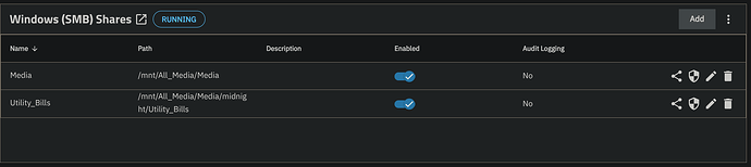

I believe the issue is to do with the dataset but cant seem to fix it. I set up the dataset/pool as “All_Media/Media”. However in Nero file explorer the path shows as “smb://truenas.local/media/midnight/Utility_Bills”. It should be “smb://truenas.local/All_Media/Media/midnight/Utility_Bills”.
I have tried deleting the dataset and starting again but it always shows up the same. For clarity, I set it up “All_Media/Media” with caps. It shows as “media” no caps in the file explorer (Nero).
I went as far as deleting all partitions of the boot drive and the 3 data drives but it made no difference. Any help would be appreciated.

If you are sharing the “media” dataset, then this path looks right. The clients do not need to know about any parent datasets, they just use the share as their root.

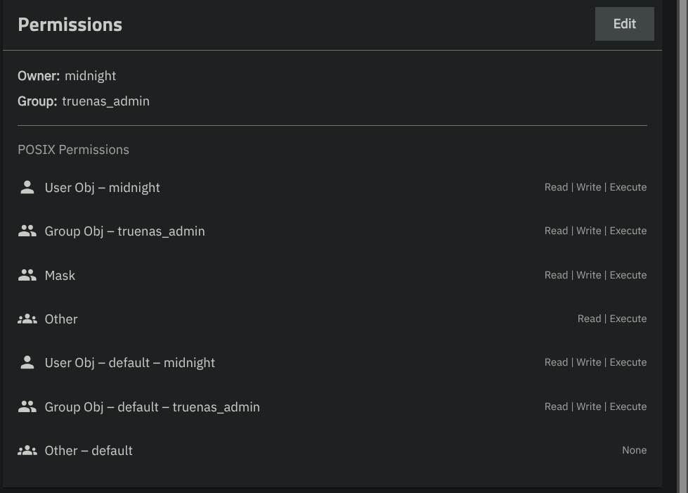

  • Permissions (post the permissions currently applied).

The reason I question the path is the old original one had the parent in the path. What about the fact that I set it up with caps but it shows without caps. Linux is case sensitive so surely that should be an issue or am I misunderstanding?
I’ll go into the shell and try running the command. I don’t think the cron command is wrong because it shows in the logs ok ad as stated it worked fine for close to a year.

Permisions

For the old install I didn’t have a separate Utility_Bills share I just added in to see if it fixed but it didn’t.

ADDED: Just want to add that I can read and write to the file with no problem so can’t see that it is a permission problem. I think it’s something to do with the path but don’t understand what. There must be someone who understands NAS file systems and access.
